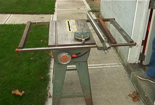

You mention the Magna Table Saw in your last post. Are you referring to the Magna Line 710 Table Saw shown in the picture below?
I an not positive but I believe it uses the same Miter as the Mark 5 as both were being made at the same time in the 1950's.
