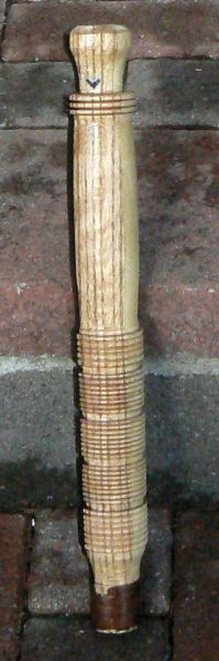

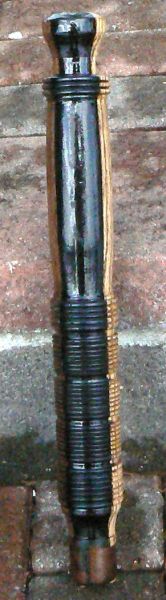

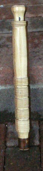

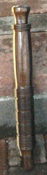

Spindle turning question(s)
Is Christmas here yet?:o
[ATTACH]11395[/ATTACH][ATTACH]11396[/ATTACH][ATTACH]11397[/ATTACH][ATTACH]11398[/ATTACH]
......North.....................South..................East..................West
The Aspen(South) was too soft for this application. It chipped out and
darkened considerably with application of 'clear' shellac.
The African Blackwood turned really dark with shellac finish.
The White Oak and Black Walnut turned out as expected(finish wise);
I did not achieve my grain orientation to maximize fleck/ray but learned a bunch!
Geez is that African Black wood dense(and oily/dirty). Spindle sanding was not an option since the black debris traveled into the pores of the other species.
The completed gavel has been posted in the 'completed projects' thread with a link to this post(and vice versa).
Yeah I turned the head insert part too small!:mad:
