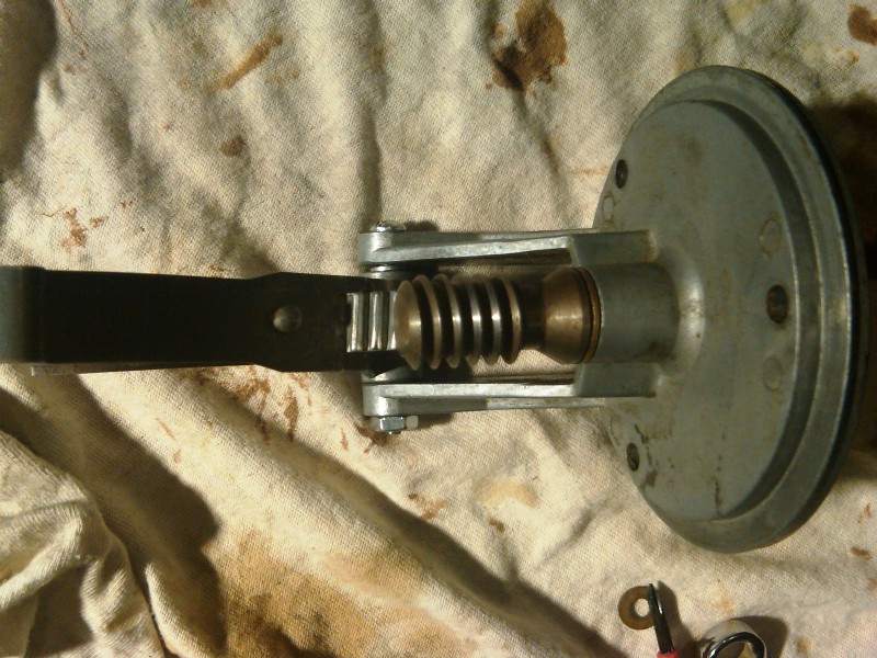

I suspect that the quadrant is a sacrificial part, designed to fail before something more expensive and/or difficult to replace.JPG40504 wrote: It amazes me that SS Inc. can develop new stuff, but seems unable(or unwilling) to 'fix' this design inadequacy. A stronger arm in the direction it gets displaced would reduce the frequency and extent of this 'failure'. Surely they are not still using the 'original' molds at this late date!
1962 Goldie Disassembly
Jim in Bakersfield:D
- Posts: 35599

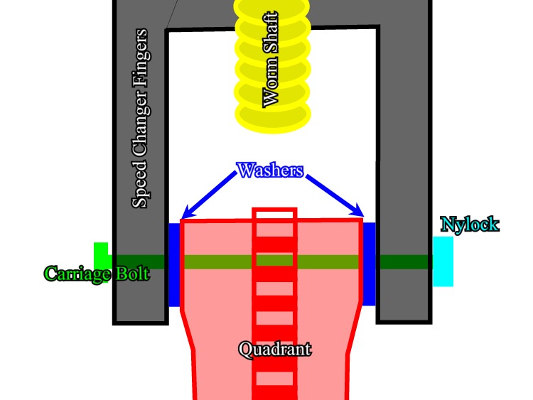

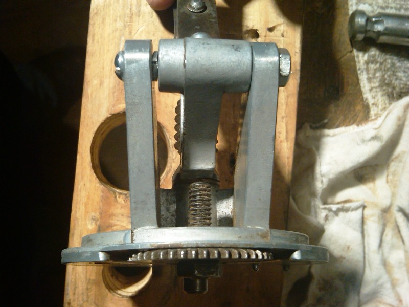

jimthej wrote:I suspect that the quadrant is a sacrificial part, designed to fail before something more expensive and/or difficult to replace.
Now that is an interesting euphemism for weak link! I am not sure what it is sacrificed to 'save'. The pork chop exerts the force on to the end of the control sheave which is a very substantial (strong) part. I am more inclined to think the speed dial(the crank) is more likely to fail due to excessive torque applied to it than the control sheave being pushed too hard. The dial would be much easier to replace than the porkchop!
Keep in mind the pork chop damage is the result of the arm displacing on the main body of the speed control. That is the weak link, not the pork chop! The damaged pork chop adds to the list of parts needing to be replaced(or repaired).
The reason Bill Mayo's 'fix' works is that it eliminates any slop in the pivot due to the roll pin. His fix also eliminates the side play of the porkchop between the two legs it pivots on. This minimizes the opportunity of the quadrant gear becoming mis-aligned with the worm gear. If the quadrant gear teeth get cocked due to the pivot slop, it creates the side force that eventually causes the leg to bend. It is a snowball rolling down hill from there. It just keeps getting worse and worse.
My original thought was the lubrication of the control sheave and damage to the wire loop that connects to the quadrant. After thinking about your response, I realize that it also is an easily observable and repairable indicator of problems with the speed control system.
I would still vote for not hardening the quadrant.
Thanks for your explanation, it helped me understand how it really works.
JPG40504 wrote:Now that is an interesting euphemism for weak link! I am not sure what it is sacrificed to 'save'. The pork chop exerts the force on to the end of the control sheave which is a very substantial (strong) part. I am more inclined to think the speed dial(the crank) is more likely to fail due to excessive torque applied to it than the control sheave being pushed too hard. The dial would be much easier to replace than the porkchop!

I do not advocate 'hardening' the quadrant. Strengthening the leg is IMHO a responsible thing to do.jimthej wrote:My original thought was the lubrication of the control sheave and damage to the wire loop that connects to the quadrant. After thinking about your response, I realize that it also is an easily observable and repairable indicator of problems with the speed control system.
If the floating sheave is operating correctly, the wire loop will never feel any stress. Its purpose is to keep the button center of the bearing from rotating only.

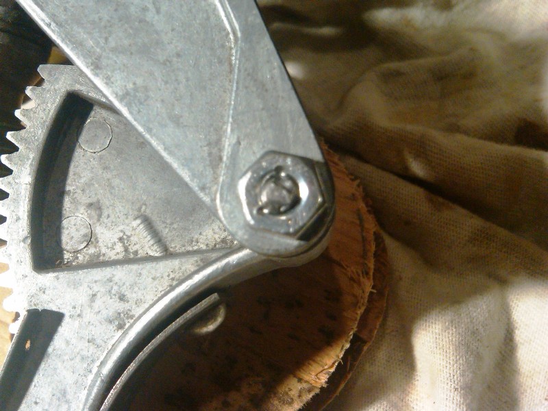

I agree on the quadrant. I tried for many years to find a permament way to strenghten the legs including combinations of pop rivits, plates and/or JB Weld. I had tried using various welding shops (MIG, TIG, etc.) including an aircraft welding shop who could not weld/solder anything to these legs. The metal is a steel alloy that is very similar to "pot metal". It melts, bubbles and disappears whenever any kind of heat is applied.JPG40504 wrote:I do not advocate 'hardening' the quadrant. Strengthening the leg is IMHO a responsible thing to do.
Thinking about this subject now, I did not try drilling several holes apart from each other and filling the indented space plus through the holes with JB Weld. The JB Weld would not stay attached to the legs (no holes) for any length of time under use before coming loose is all that I did.
Therefore, I would be very interested in learning if anyone else has been successful getting any type of reinforcement to stay attached to these legs.
