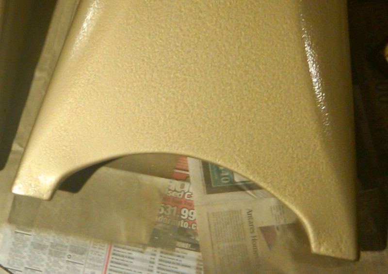

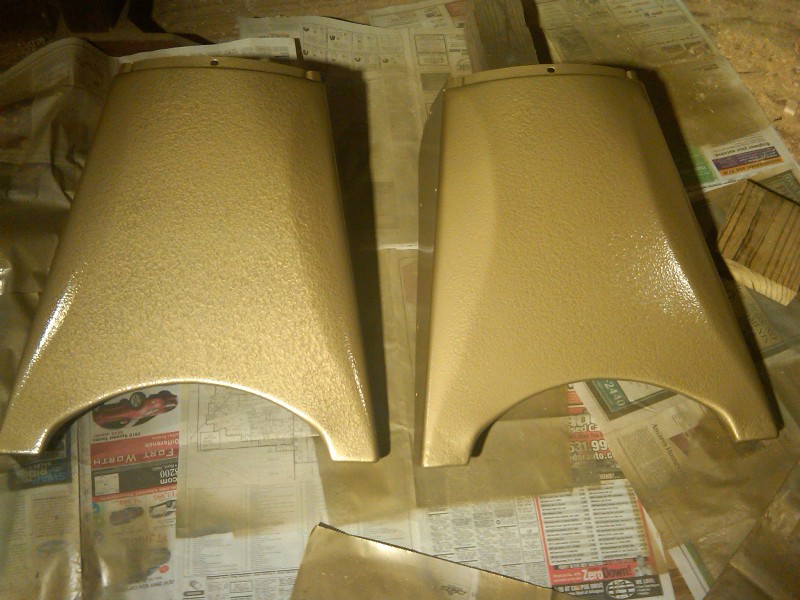

Painted Legs
Here's the painting progress for the legs. I sprayed them with a coat of self etching primer and then two coats each side of the Hammered Gold. I felt like it needed it with the amount of rust on the feet. Got a little thick on one.
