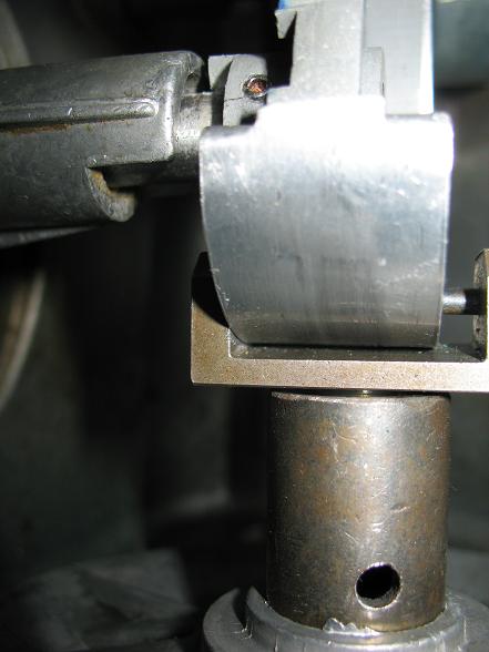

rkmhd wrote:It looked like a glue... I scraped it with a screwdriver. It turned out to be some old dust mixed with some grease, and belt dust from over the years.
I just don't see how it can be adjusted any at all. I must be missing something. With the gear all the way pack you can see it sits perfectly where the gear is missing/worn away. If there was a new gear to replace it with there wouldn't be much gear bite to work the stock up and down the track.
Glad to hear it wasn't really 'glue'!
Cannot tell for sure, but your pix appear to indicate the gear is 'low' relative to the worm gear. Are all the retaining clips in place(3)? Is the bottom of the gear worn? Maybe a washer will could 'raise' it, but I do not see the two pins disengaging the pinion gear either. It is possible the 'glued' shaft has dropped down? I now believe the shaft is finely splined and was driven into the casting boss. Does much of the 'splined' portion extend below the boss?

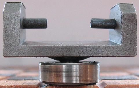

I picked up a mark VII a few months ago. Little did I know what I was getting into. It worked at the previous Owners house. I tried to use it at home and it would hum and not turn. So I took the headstock off. and took it appart. The belt was stuck in the shelve. So I took the belt off and ended up getting a new one. Then I took the motor appart because the wires were literally falling appart. I nipped them back and soldered in new wire with some shrink wrap. Everything seems to work pretty good. The unit does get quite loud at full RPM, and I noticed the speed selector turns on its own a little. For the most part I fixed that issue. The latest is the gearing that moves the headstock up and down. I don't quite understand what needs to be fixed on it. I can move the gear forward on the shaft to connect with the drive gear of the handle. It stayes there as long as the headstock is going down. As soon as I rotate it to go upwards. The gear slides out of place and it just sits there. Can anyone shead some light on this please. I am in the middle of uploading some pictures of the gear to see if it makes any since to any of you guys.
Thanks,
Hi rkmhd,
For "the speed selector turns on its own"
There is a metal cam follower which the plastic cam pushes and pulls as the speed dial is rotated.
The plastic cam can be installed 2 different ways on the cam follower... yes the right way and the wrong way ]11529[/ATTACH][ATTACH]11530[/ATTACH]
It is not easy to see here, but the surface of the metal cam follower which comes in contact with the plastic cam is actually beveled.
One side is thicker than the other. The thicker side should be on the top.
Both pictures show the thinner side of the cam follower.
When installing the plastic cam onto the cam follower, the cam follower will naturally want to rotate such that the heavy side will be down.
That is the wrong way.
If installed like this, the result will cause the speed dial to increment on its own while in operation.
If you are going to remove the cam from the cam follower; check the cam follower bearing by rotating it. If it is bad or going bad - replace it!!!
When that bearing goes bad; it will get very hot and melt the plastic cam.
~Ryan

ryansm7. I think you hit the nail on the head with the cam follower.....I will check that tomorrow or a few days... I kinda took a bad fall on some ice the other day and I haven't had time to play in the garage yet.

Well I got out ther in the garage today. I got good and bad news. Good news is my speed selector is now working properly. I moved the cam guide around. That threw off the speed dial a little. Actually it let the sheves open up too far and started to eat my new belt. With a little adjustment It was good to go. I still used my little washer I made to fit between the snapring and the dial selector. It seems to take up much needed slack and makes the dail more presice on the clicks. Works great now. Thanks Ryan...
Now for the Gear that rides the pinion to raise and lower the headstock. All the parts are on the shaft that holds the gear that is chewed up. The shaft hasn't moved. I for the life of me cant figure out why this was made this way. Its not like their is a lever on the headstock that pulls the locking collar in and out of the gear. Crazy. It looks like I may need to do a replacement gear.
Posts: 35449
rkmhd wrote:Well I got out ther in the garage today. I got good and bad news. Good news is my speed selector is now working properly. I moved the cam guide around. That threw off the speed dial a little. Actually it let the sheves open up too far and started to eat my new belt. With a little adjustment It was good to go. I still used my little washer I made to fit between the snapring and the dial selector. It seems to take up much needed slack and makes the dail more presice on the clicks. Works great now. Thanks Ryan...
I think the 'pull down' disk is to allow manually disconnecting to allow unrestrained movement when servicing(partially disassembled). It is possible the disc was not rising far enough(weak spring?) so that the gear was riding low?????????? This assumes the pins did originally push the gear up!
