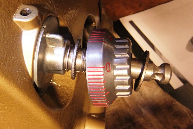

We need to see inside the dial. Does the retaining clip clear the housing by about 1/16"? Is the flat 'washer' thin?(.040") Take a pix with the washers and dial etc. removed. Is the flat washer hitting the inside of the dial?

Here's the quill feed without the washer.
[ATTACH]11607[/ATTACH]

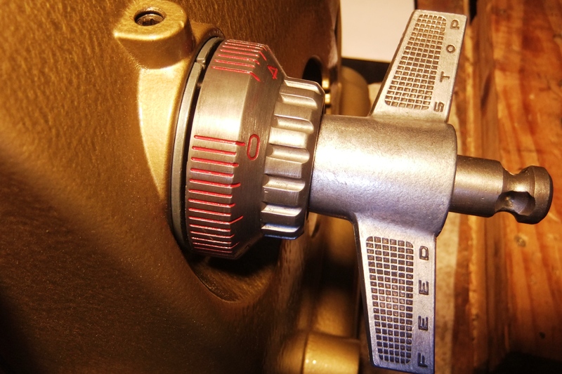

And the resulting spacing. This looks "normal" to me compared to photos of other SS.
[ATTACH]11603[/ATTACH]

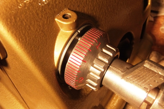

Here's with the washer.
[ATTACH]11605[/ATTACH]
[ATTACH]11604[/ATTACH]

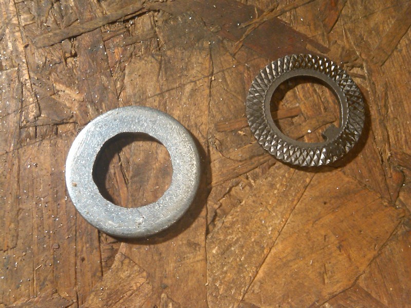

Here's the washer. It's 3/32" thick. It was one I had in the shop and filed the ID down to fit. Again, when I picked up the SS it didn't have a washer.

FYI, I've seen a few Mark V's working without the washer there, into 1980s vintage. I'm not convinced they were always used -- maybe at least being dropped during a rebuild some time.
Your fabricated washer is certainly thicker than the factory ones. The factory ones are definitely thin.
Sharp looking machine there!

Notice the washer is nearly as thin as the retaining ring
