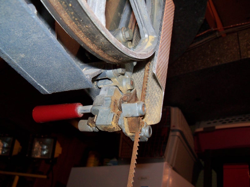

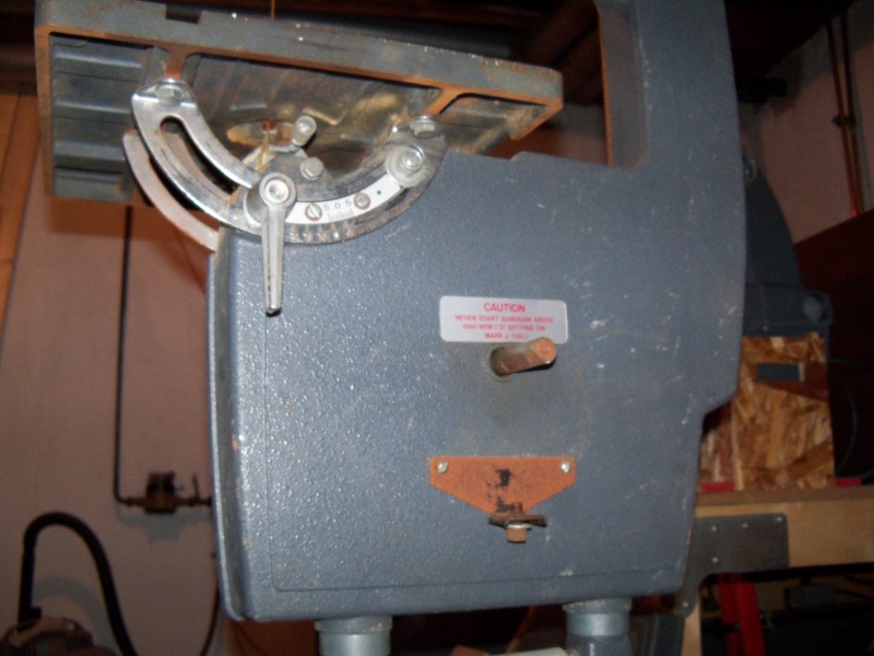

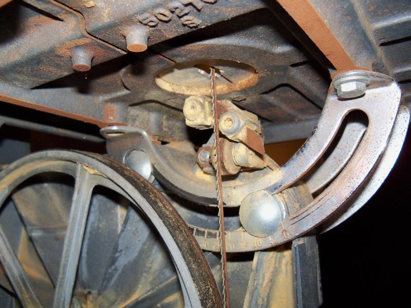

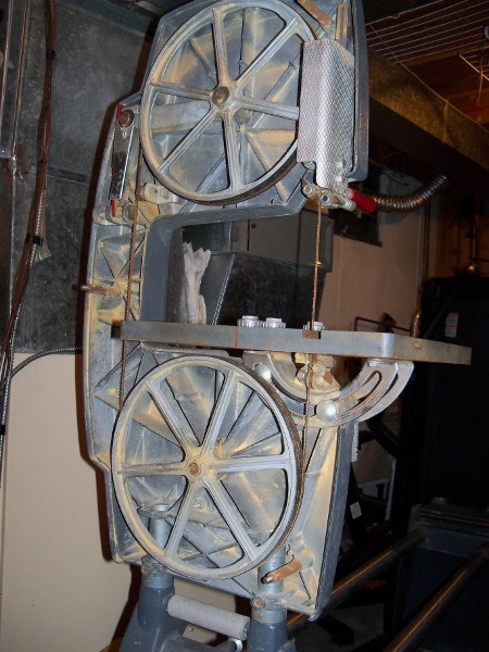

Now to start on the bandsaw and finish off the list of parts I'll need. Here's what I've got to work with.

Some rust, lots of sawdust, and at least one screw missing. Those guide blocks worth trying to save? The blade looks pretty toast

From what I see in the pictures the bandsaw's tires look pretty good. Clean them up with a nylon brush and some mineral spirits.
You have the old bronze back-up rollers. I would replace them with the new ball bearing types. You might as well get the cool blocks at the same time. The band saw will then run much quieter.
The new cover, with the tensioning window and dust port, is a little expensive, but nice to have.
Step 1 - release the tension on the blade! The red bar may already have been over-stressed.
Step 2 - You already know how to handle the rust. Judge the blade guides after rust removal.
Step 3 - I would get a upper blade guide upgrade(two bearings replace the one).
Clean, clean, clean. Once that crud is gone, clean the tires as already said. I use my finger nail to scrap the tires to remove anything embedded. An old credit card works too. I cut a lot of aluminum which embeds badly and must be removed soon after.
I would also discard that blade and start new. The blades are available most any where they handle bandsaw blades. Seventy two (72") inches is what you need.
I don't know for certain about the older bandsaw but the upper wheel bearing probably needs to be greased and I don't believe there is anything to be done to the lower bearing.
Please don't use it without a cover. I have never seen anyone who was mangled by a flying bandsaw band but I'll bet it is nasty.
I do have the bandsaw cover and its in perfect shape, just not in the pics. But no cleaning today. Its too damn cold outside (-20C / -4F) to scrub and soak in mineral spirits.
