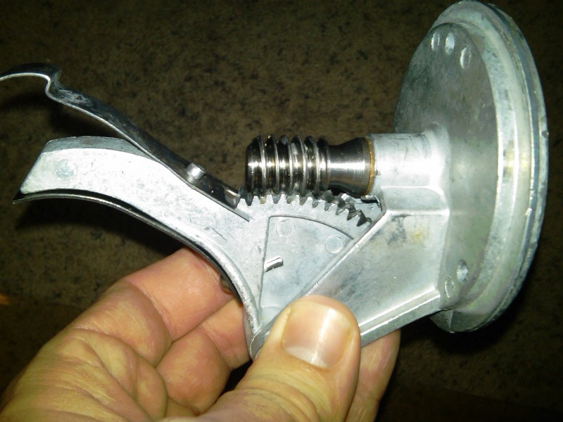

A new speed changer came in the mail today. I felt it best to avoid dealing with a bent shaft and bent ears. The quadrant teeth are neatly caked with lithium grease or whatever it is. Should it be removed or is it intended to be in place during use? Seems like it would attract a lot of dust.
[ATTACH]11911[/ATTACH]
I also noticed that the gear on the face of the speed changer came with the beveled side down. Also, the worm screw is firmly set against the back of the dial. No play along the shaft as with my old one.

Yes I now believe the beveled side belongs down. When I created the reassembly thread, I was having a clearance problem with the crank that reversing it 'fixed'. Thread has been corrected!.ddvann79 wrote:A new speed changer came in the mail today. I felt it best to avoid dealing with a bent shaft and bent ears. The quadrant teeth are neatly caked with lithium grease or whatever it is. Should it be removed or is it intended to be in place during use? Seems like it would attract a lot of dust.
[ATTACH]11912[/ATTACH]
I would leave the grease as is. If it collects dust, it can be replaced with graphite or whatever be yer choice
Far more important is sheave shaft lubrication and sedate slowing speed down adjustment.
That screw is a newer design that apparently has a raised slotted portion. We be interested where the nut/end of screw location ends up after 'high speed adjustment' with the 'new' screw'. Also if it needed to be moved much from 'as shipped' position.(i.e. Are they preadjusting it during speed changer assembly to eliminate the need at final assembly of headstock).
At high speed the screw was about 1/8" above the nut, which was about where it was as shipped. I still don't have the belt within 1/8" of the lower sheaves but I'm tired of fiddling with it. 1/4" will just have to do until I get my patience tank refilled.JPG40504 wrote:...That screw is a newer design that apparently has a raised slotted portion. We be interested where the nut/end of screw location ends up after 'high speed adjustment' with the 'new' screw'. Also if it needed to be moved much from 'as shipped' position.(i.e. Are they preadjusting it during speed changer assembly to eliminate the need at final assembly of headstock).

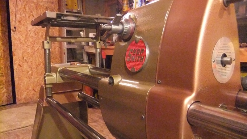

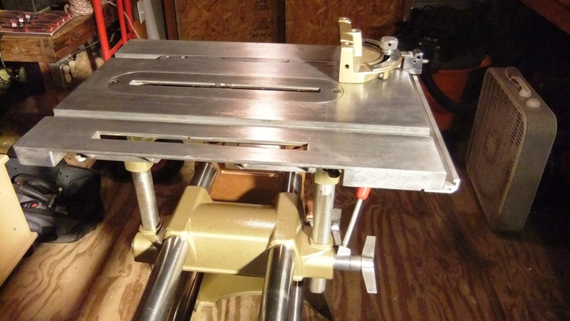

The new motor came in from Bill Mayo this weekend and I got everything reassembled. The U-drive screws for the nameplate on the headstock came in tonight and the danger sticker in place. I still have a few accessories and arbor to put the finishing touches on but I'm calling this thing DONE!
Here are some photos of the completed 1962 Goldie. She runs great. Thanks, Bill! He installed a reversing switch, new toggle switch, new bearings, sheaves, cord and basically a whole new motor.

I'm working on a video and I'll post some before and after pairs soon. Thanks to all of your for your help, advice and a few spare parts!

She really looks good! Great job! You can take pride in that!
Consider putting her in the 'restored' thread by shipwright!
You are doing a fantastic job of restoration. It is like a new production release gibing the machine still another twenty five to thirty years of usability. Great job.
I'm looking forward to viewing your next video. Hope you have greater success than I have been having. I started and scrapped at least three sessions.
