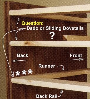

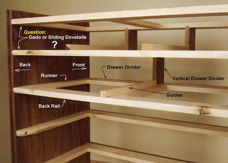

I'm making a chest of drawers and looking for some advice on the carcus joinery (side to runner): Dado or Sliding Dovetails?
I'd like to have it as sturdy as possible, but don't understand the variables.
I understand that a dado would be a typical method to allow for humidity changes and expansion.
Would a sliding dovetail allow for expansion just as well?
I'm using hard maple for all materials.
[ATTACH]11947[/ATTACH]
- WebFrame004s.JPG (37.52 KiB) Viewed 6363 times

Also, I'm not sure about terminlolgy]11948[/ATTACH]JPG40504 wrote:With center drawer guides, I would think dado slides would be adequate(and less prone to sticking).
I've read that only the first three inches (toward the front) of the runner should be glued and screwed to the side of the carcus. Since the runner is in the Dado/Dovetail it allows for expansion from front toward the back direction; since the back is free to move.
The strenght I'm looking for is holding the carcus "side to side" firm, but again I'm not sure about the side to side expansion versus front to back expansion.
It seems that a dado would allow the "web frame?" to move in all directions;
whereas a dovetail would only allow movement from front-back.
- WebFrame005s.JPG (38.85 KiB) Viewed 6353 times

I answered the wrong 'question'. I would dovetail per your need for side to side support as you described above.ryansm7 wrote:Also, I'm not sure about terminlolgy]11948[/ATTACH]

Hi Ryan!
Since you are using solid maple boards for the sides rather than plywood - the wood movement to be concerned about is the front to back movement of the two sides. The deeper the chest (wider the sides) will give more movement.
The runners do not present a movement concern, as their long grain will run from front to back and movement is negligible along long grain.
Seems to me you definitely have two options here:
1) If you have no problem making sliding dados this would be the preferred way to go for longevity. As you have indicated glue on the front few inches would be plenty to hold the runner in place. The dovetails will also add side rigidity to the chest.
2) The second choice is to make dados. these would work well if you make three glue blocks to place under each runner. These blocks would be glued and screwed to the sides. --two screws each toward the front and back of the blocks to allow room for a slot. The slots will allow a screw to pass through the block and into the runner. These slots would be about 1/2" or 3/4" long and would allow the vertical screws (the screws driven into the runners) to slide forward and backward. This second choice would hold the carcase and the runners quite firmly also. The only problem in using blocks is - Would they impede movement of the drawers. If you have some side room for the blocks this is an easy way to go.
Concerning chest stability - the back that will be fit into the rabbets shown in your pictures will add tremendous resistance to racking of the chest.
P.S. I see in your pictures, you will have center drawer guides. Will you also have side guides or will the drawers ride agains the carcase sides?

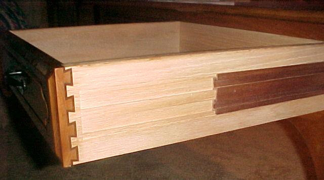

Thanks for the advice. I am in the planning stage right now and will keep a record of the project.
I've always liked the dovetail joinery. Probably since watching my dad's endless repairing of box joint dresser drawer.
They never seemed to stay together.
The chest will actually be used for storing tools in the shop. I'm hoping to make several variations. Peg board never quite worked for me - kinda like looking in the pantry for a can of tomato soup; I can't find it but I know it right in front of me.
As for the drawer guides; I'd really like to do parallel sliding dovetails.
[ATTACH]11962[/ATTACH]
Check out this article in Fine Woodworking from March/April 1996
"All-Wood Extension Drawer Slides - Telescoping dovetails support a fully opened drawer with style by Karen Robertson"
[ATTACH]11964[/ATTACH]
