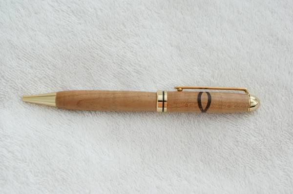

Some people say that you can't do small projects on a SS
[ATTACH]12028[/ATTACH]
OK nuff said
OK nuff said

- inlaid pen.jpg (78.29 KiB) Viewed 17333 times

I echo that...robinson46176 wrote:I would not hesitate to build a house or a barn with one. Is that big enough.
Get a couple of roller stands for in and out feeds, set the auxilary table height to match the main table height and your effective table size is enormous. I have built a dinghy, a canoe, two full size armoires, small tables, little chairs, big chairs, candlesticks, little boxes, big boxes etc etc. No limits...go for it!
