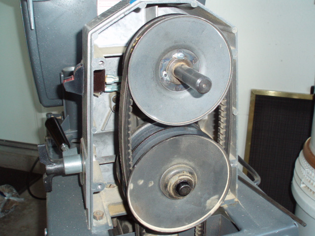

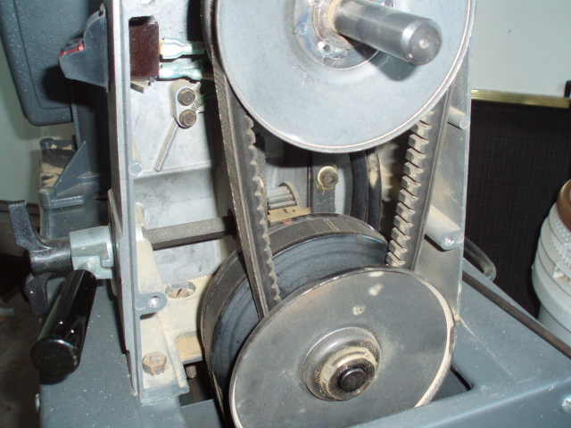

Have you pulled the cover off the power station so that you can watch the variator at work while you change the speed dial.
[ATTACH]12396[/ATTACH]
High Speed
[ATTACH]12397[/ATTACH]
Low Speed
This shot shows the relationship of the Speed dial and pulleys. Don't be confused by the switch and wiring. This shot is of the Crafter's Station.
