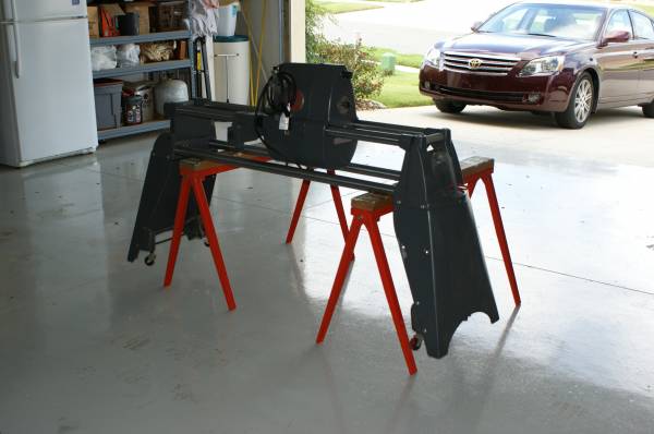

dusty wrote:I would take the legs off to lower the center of gravity and slide it into that truck. It'll fit. Tools Required: Large flat screw driver and small crescent wrench.
Do you think it's ok to place the shopsmith on saw horses, resting on the lower tubes, while you remove the legs?
tomsalwasser wrote:Do you think it's ok to place the shopsmith on saw horses, resting on the lower tubes, while you remove the legs?
Yes. And for reattaching them also!:)

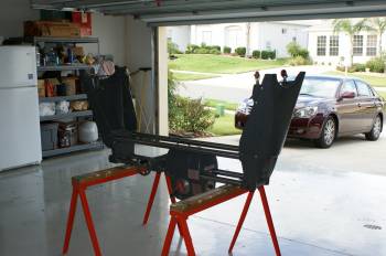

Post by wa2crk »
Tomsalwasser;
First put it on sawhorses and then roll it over. Like this.
[ATTACH]12631[/ATTACH]
and then like this.
[ATTACH]12632[/ATTACH]
Bill V
SS on saw horses.jpg (81.66 KiB) Viewed 5389 times
SS upside down.jpg (67.34 KiB) Viewed 5388 times
wa2crk wrote:Tomsalwasser]12631[/ATTACH]
and then like this.
Bill V
Make sure you do not roll it 'off' :eek: the horses!
