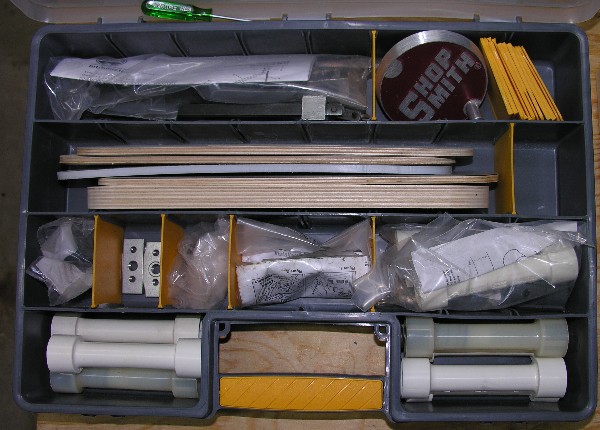

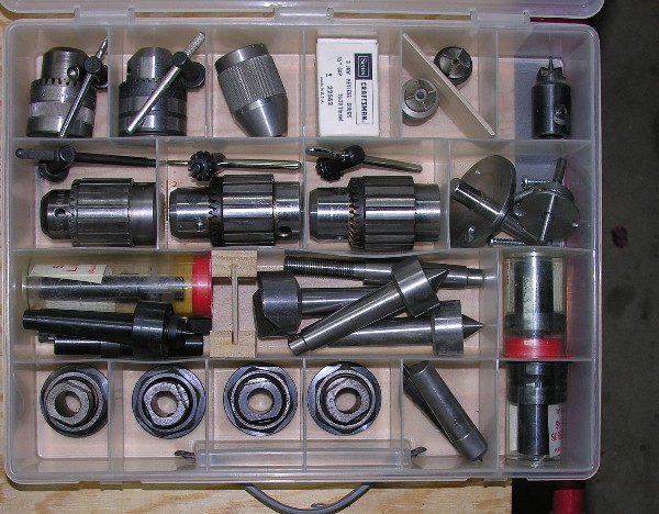

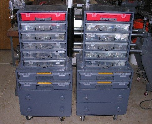

Hi Folks,
I move my Mark V quite a bit as my shop is very small, so a cabinet under it would not work well for me and yet I to needed a place to keep all of the various accessories used with the tool. I built the two small rolling cabinets and used some plastic organizers that I found at the local lumber store. The organizers pull out so I can see just what I need. Amazing how much SS odds and ends you accumulate when they are finally in one place.
ldh
ldh
