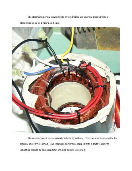

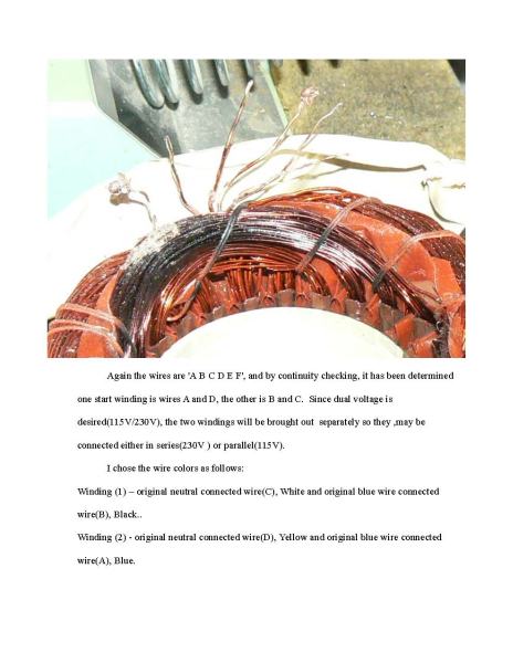

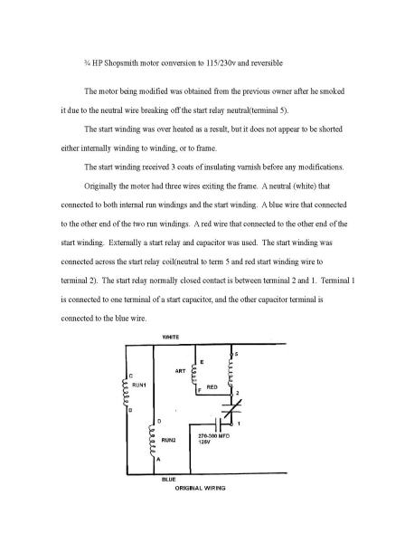

stockew wrote:Maybe we could get a schematic of the motor-reversing electrical set up.....??!! :-)
The motor must be constructed(wired) such that you can isolate the start winding from the run windings. Not always are they accessible.
Modifying involves disconnecting existing internal windings from wires that exit the motor, and re wiring. The start winding must be isolated from the run windings. Then it is merely a matter of reversing polarity of the start winding wiring.
The attached files have been reduced to get them to upload. PM me with an e-mail address and I will send a full sized pdf.
[ATTACH]12959[/ATTACH]
[ATTACH]12960[/ATTACH]
burnt motor description_Page_1.jpg (28.75 KiB) Viewed 6783 times
burnt motor description_Page_2.jpg (33.78 KiB) Viewed 6777 times
burnt motor description_Page_3.jpg (38.03 KiB) Viewed 6774 times
burnt motor description_Page_4.jpg (41.75 KiB) Viewed 6773 times
rewiring a 3/4 hp GE motor to reverse with dual voltage
continuing...

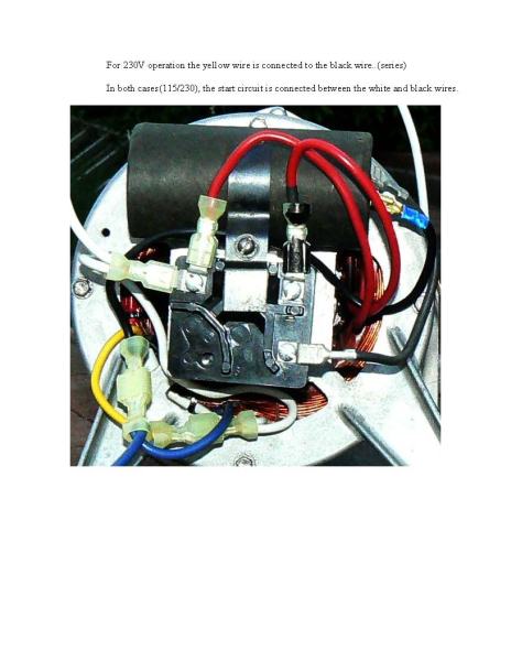

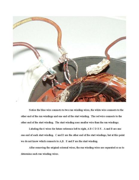

[ATTACH]12963[/ATTACH]
[ATTACH]12964[/ATTACH]
[ATTACH]12965[/ATTACH]
burnt motor description_Page_5.jpg (34.48 KiB) Viewed 6766 times
burnt motor description_Page_6.jpg (35.51 KiB) Viewed 6771 times
burnt motor description_Page_7.jpg (11.11 KiB) Viewed 6761 times
