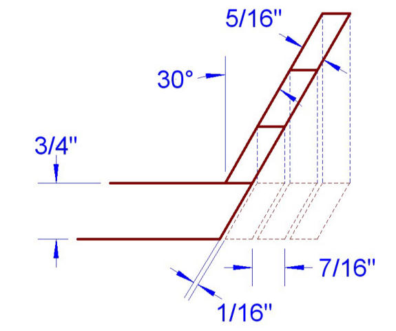

This coming weekend, I’m going to address how to create bowls with straight sides from a single piece of wood. Select the thickness of your stock (up to 1”) and the slope of the bowl wall (up to 45 degrees), then calculate the “ring spacing” needed to achieve it. You can also figure the wall thickness, if you want. The illustration below hints at the process. If you plane your stock to 3/4” thick and want to create a bowl with walls sloped at 30 degrees (not the suggested 22-1/2 degrees), cut rings every 7/16”. (3/4 x tan30 = 7/16) They will match up perfectly.
