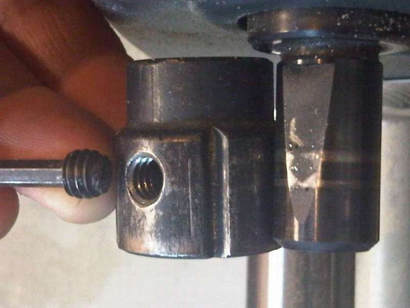

I have also had this problem with the arbor set screw loosing up on my while usng my bandsaw. I am wondering if my set screw is bad or the incorrect type. I am using a powerpro and I took the drive-hubs & set screws from my older 500 series headstock. As you can see in the picture the hubs don't sit very far onto the auxiliary spindle.
Are there special set screws and/or special hubs for the powerpros?
I had to replace a broken power coupler after the set screw loosened up and overheated. So this problem is becoming annoying and costly.

pjallen wrote:I have also had this problem with the arbor set screw loosing up on my while usng my bandsaw. I am wondering if my set screw is bad or the incorrect type. I am using a powerpro and I took the drive-hubs & set screws from my older 500 series headstock. As you can see in the picture the hubs don't sit very far onto the auxiliary spindle.
Phil
That is the normal position. Wear around the shaft is not!
The power pro will exert more torque(pulsating) than the induction motor. The setscrew 'security' is therefore more necessary. I would replace the setscrews. Make sure they are 'flat' bottomed.(no cup or serrated cup). I grind them flat(they are more commonly found).
And... to pick up where member charlese has reported on the PowerPro and the bandsaw, the power-coupler needs to be a tight-fitting one. If the power-coupler is a little bit loose, then the increased backlash between headstock and bandsaw-wheel aggravates the pulsing tendencies.JPG40504 wrote:That is the normal position. Wear around the shaft is not!
Chris

Are you getting vibration/clanging with the bandsaw? That was loosening my set screws, and I broke a coupler because of it. A call to CS to adjust the settings may be in order.pjallen wrote:I have also had this problem with the arbor set screw loosing up on my while usng my bandsaw. I am wondering if my set screw is bad or the incorrect type. I am using a powerpro and I took the drive-hubs & set screws from my older 500 series headstock. As you can see in the picture the hubs don't sit very far onto the auxiliary spindle.
Phil
Michael
