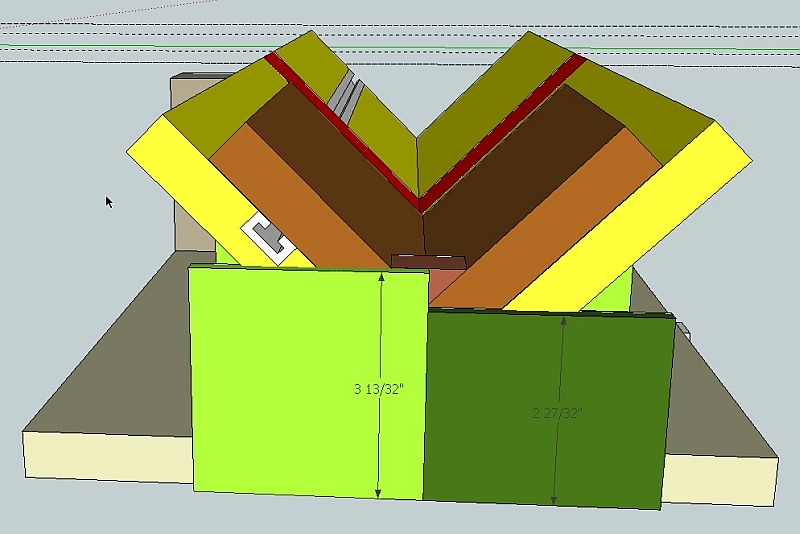

If you have been following the posts it should be clear that the design has a problem. The following sketch should show you just how big the issue is.
[ATTACH]13837[/ATTACH]
Let me try to work everyone though it. Starting on the left the green box represents the maximum cut of a 10" blade(3 1/4"). From the "V" notch the extension is 1 7/16.
From the left is the red box which shows the max. depth of cut for an 8" blade (2 1/4"). The "V" notch now shows just 7/16" of extension.
The blue is a 6" blade, as you can see it will not even complete a cut though the jig let alone provide a spline cut.

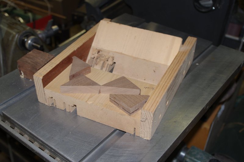

Here is another example of a jig to add splines/feathers to the mitered corners of boxes.
[ATTACH]13843[/ATTACH]
The jig itself is guided by the rip fence, which you set to determine how far the spline/feather is inset from the top or bottom of the box.
It's made from a piece of 2 x 8 with wood strips attached to both sides to reinforce the jig. Simply tilt the table to 45 degrees and cut out the center section of the jig to form a trough that holds the box when cutting the spline/feather slots. Leave about 1/8" of the 2x8 at the center when cutting the trough. The scrap center section is then glued to the top of the jig to give added support for the box. Those triangles are examples of spacers used to adjust the location of the slots without have to reset the fence.
I used screws to "clamp" the sides to the 2x8, but removed them after the glue dried.
Another method would be to simply crosscut the 2 x 8 in half at a 45 degree angle and then flip over one of the pieces to form the trough for holding the box. Then cut a triangular piece or two to deepen the trough.
This jig won't cut really deep slots, but could be made to do that by adding additional layers of 2x8 and wider strips to the sides.
I knew a guy selling jewelry box, etc., that cut really deep slots in some of his boxes. They protruded into the interior of the box so that a lift-out tray could be supported.
Another point about using one of these jigs is that you want to use a saw blade with a flat top profile so that the slot has a square bottom. I have several -- one is a Freud 60 tooth, thin kerf blade (I think it was sold as a model 404, but don't know if they still sell this model). Another is a 7 1/4" blade that I picked up at Home Depot years ago called Laser.

Keep the "V" as intended, but split the base. Gain = 3/4" cut depth. The support wedges become more critical to alignment of guide bars and strength. i.e. the "V" becomes the main support stucture. The base will have a through slot in the middle anyway!

I was working on images while JPG posted. I think that we are on the same wavelength here. That's scarey.
I like your concept and I see the issue with limited depth of cut. Here is an image that I think may depict a solution without changing concept. I would consider making the base thinner along with imbedding the sides so that the vertex of the v groove is at surface level. This approach would gain about an inch of depth in the available cut.
I would also consider 1/2" material even for the v groove and structural braces. to further reduce weight.
