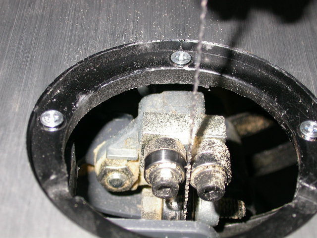

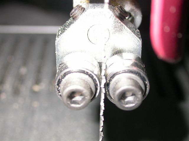

I just installed one of the first Carter Band Saw Conversion Kits and I really love it. It comes with 8 bearings that replace the Cool Blocks that replaced the steel blocks that came with my Shopsmith Bandsaw. The saw is very smooth and now cuts straight as an arrow without lead, I also replaced my blade with a Shopsmith premium blade which may get some of the credit.
The bearing upgrade was not cheap at $113 with shipping but I am very happy.
The instructions were very easy to follow and the whole thing took 5 minutes.
I have had requests for pictures, let me know if anyone wants another view.

The top bearings and stabilizer fit in the same slot, Carter said the bottom bearing and stabilizer do work together but the adjustment would be very difficult with an extremely small blade that has any set in the teeth. The bearing needs to sit just behind the gullet.
Once you figure out how they are installed it takes less than a minute to swap the bearings for the stabilizer and a little longer to go the other way. The first time you remove the cool blocks does take some time and force, I used a small hammer and large nail set. I waxed the new ones before installing them.
For Re-sawing the are great because they support the entire blade.
I did replace my blade when I installed the guide, I found the old blade had a small kink which I am sure effected drift.
