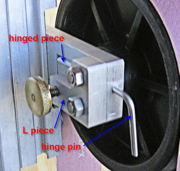

I assume this adjusts tracking.
[ATTACH]16882[/ATTACH]
Please explain.

Here is a closeup of the end of the idler arm. The idler wheel axle screws into the other side of the hinged piece. The L piece carries the tracking (brass) screw. The brass screw bears on the hinged piece and adjusts tracking. Works well! :) I found the basic idea for this arrangement here:
http://www.shopfloortalk.com/forums/sho ... hp?t=22559
[ATTACH]16885[/ATTACH]
idler arm.jpg (74.88 KiB) Viewed 34321 times
Peter
Thank You! The hinge pin had me cornfuzed!:rolleyes:

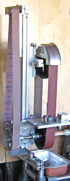

This device begs for further development........here it is as a two belt machine, with a fine 1.5" by 60" belt and a coarse 2" by 48".
[ATTACH]17300[/ATTACH]
There is a steel platen behind both belts. The pan came from a local thrift shop. I used a 5" aluminum drive wheel this time and made another idler arm like the first, but reversed to work on the left of the post. I have it set up on my mini and it works very well for metal or wood but I must pull the end cover off and see if any metal grindings are being pulled into the headstock!:(
