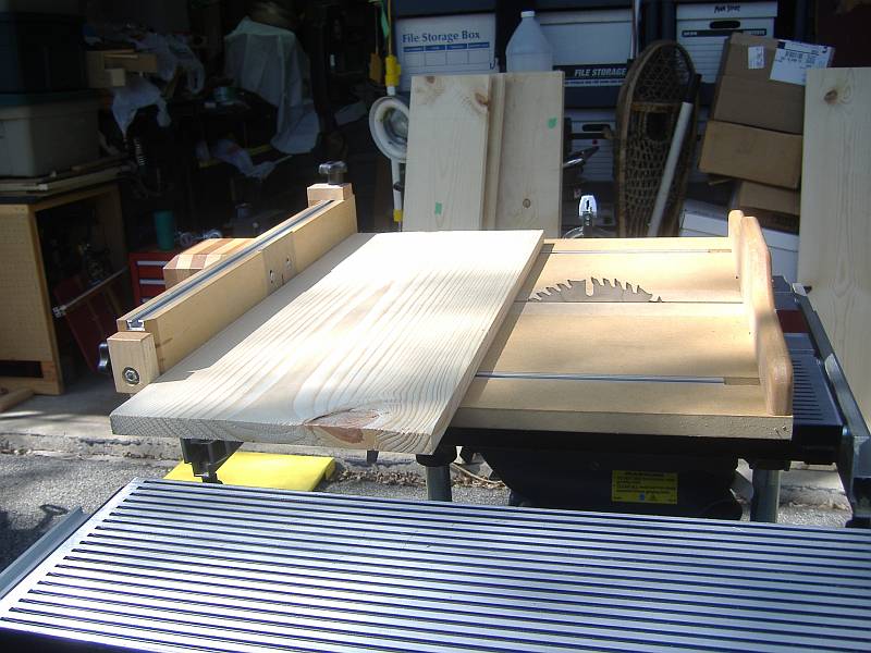

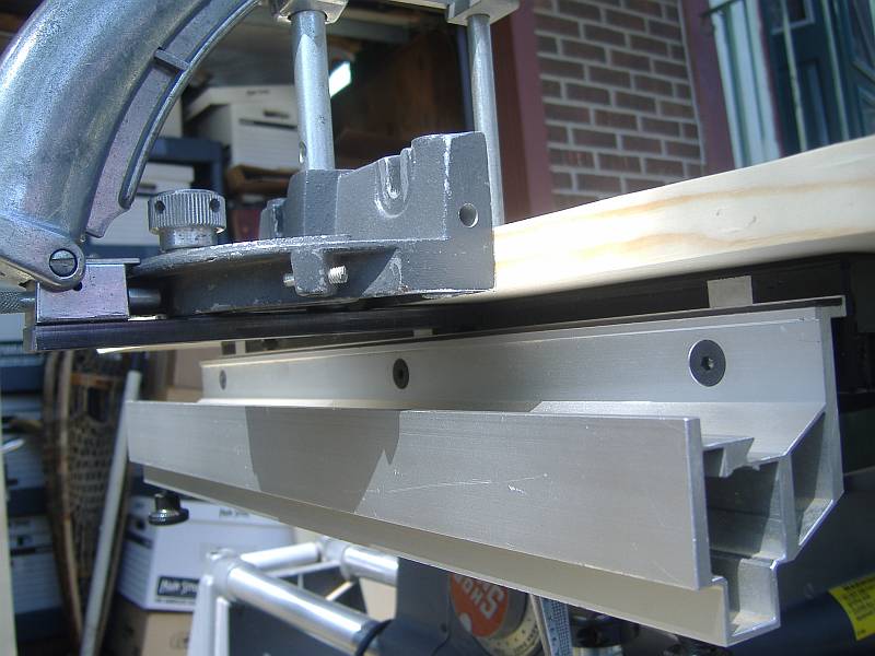

For planning purposes I set the blade height as shown. This then determines where the stock first touches the stock and where the thru cut ends.
[ATTACH]16870[/ATTACH]
[ATTACH]16871[/ATTACH]

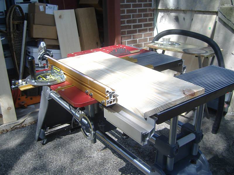

The this stock is 11-1/4 wide about as wide as I like to go with the standard setup. As can be seen below the standard miter gauge will be off the front of the table. The miter gauge has the t-slot so I'm not worried about it tipping too far and it has plenty of bar in the slot to make this cut. This is not always the case and again if you don't feel safe doing this then please don't try. (again we are using a 520 with the larger table here)
[ATTACH]16872[/ATTACH]

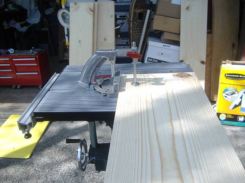

B) Use a Incra miter express with a 1000HD miter gauge mounted to it.
[ATTACH]16873[/ATTACH]

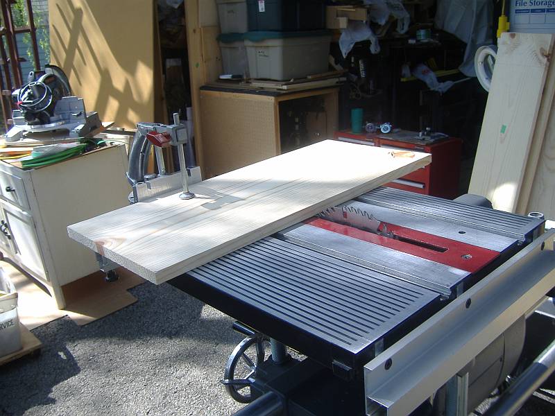

C) One of my favorite sleds.
[ATTACH]16874[/ATTACH]
