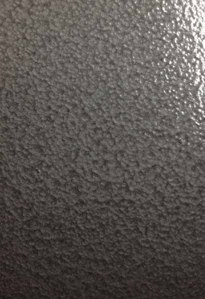

In an earlier post I said I was using Rustoleum's Hammered Gray. Here's a closeup picture of the texture and color. It's smooth to the touch.

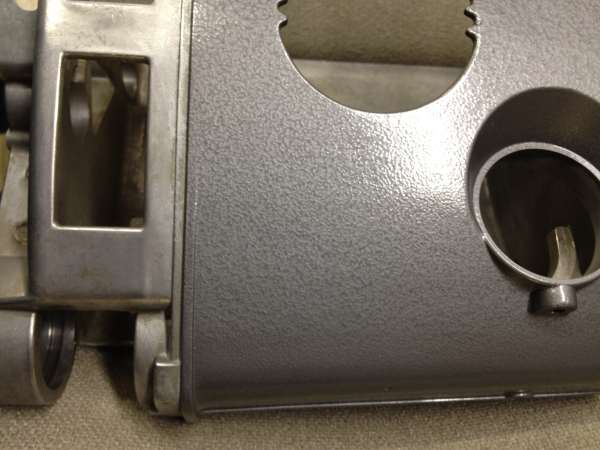

Here's a picture of the casting. I masked off the area under the belt cover so this shows the grayness of the paint in contrast to the bare aluminum. This gray is lighter than both my original 500 and my redie (which no longer exists as a color). The closeup pic is taken from the middle of this pic.
