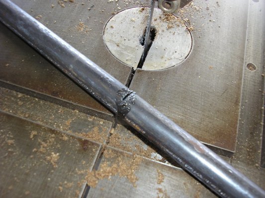

here you go. Action shots and my tip of the day.
This is a 3/4 bar on setting E. Lubricated with 3 in one. Any lube will do as coolant.
[ATTACH]17122[/ATTACH]
But I used oil to clump the shavings together better.
[ATTACH]17123[/ATTACH]

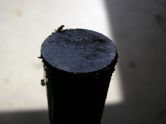

Nice cut. Square and no burrs.
[ATTACH]17124[/ATTACH]
