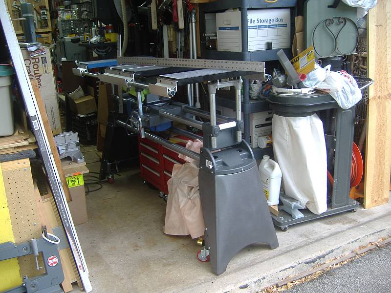

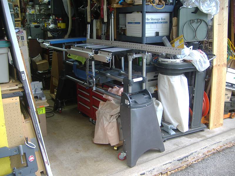

More data and good news!
Let's just cut to the chase, I have an extension table mounted on both ends and the main table between.
[ATTACH]18036[/ATTACH]
If I loosen the main table screws the main table slides along in either direction with no more then normal force (this is just a judgement call).
[ATTACH]18037[/ATTACH]
Let me add a bit of detail. With the main table height set and locked in place I used my drywall square as I usually do, to set the extension table heights. Did the left one then the right one. All tables are flat with one another.
I then slipped the 5' bars in. They need a little guidance as they come in just a fraction off and hit the bottom screws unless you back them off all the way (I gave the tubes a little lift to get past them. Same thing when they get to the far end. I did the front tube then the back tube. NO force required and when in place they slide along quite well.
I do not think it gets any better then this and I am not even going to try.
So my conclusion is that either I've gotten a lot better at this over the last year or the new double tilt makes all the difference.
I was thinking of adding extension tables to the mix but since they align to the rails I see no reason to believe anything will change but we will see. I have another 15 minutes to do that before I have to start putting things away. So in a half hour or so I'll report what I found.

New post to follow.

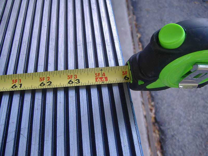

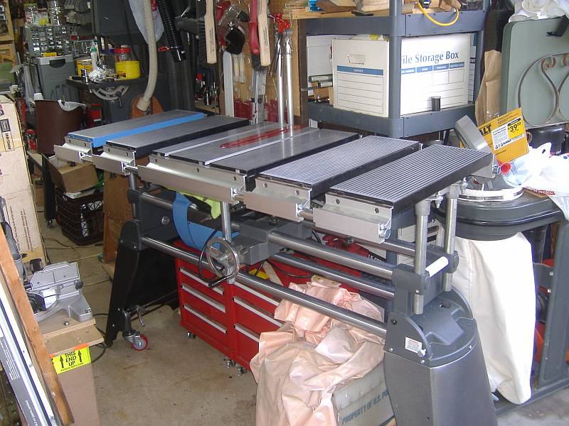

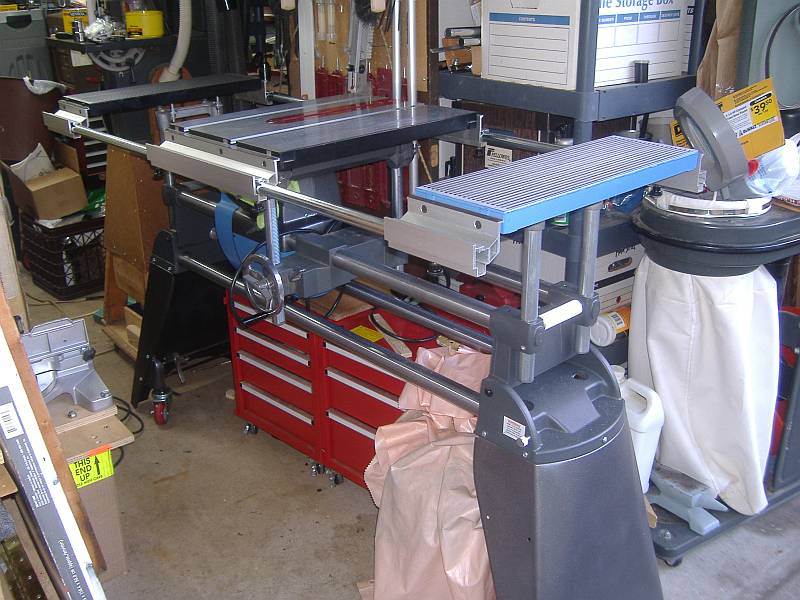

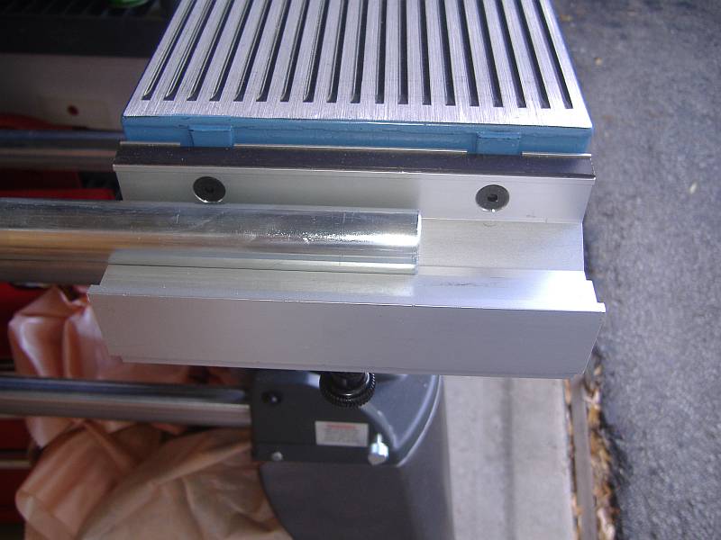

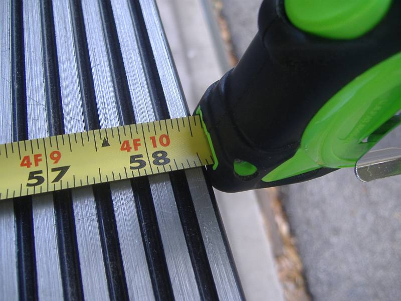

Since we had some downtime this is a little later in the day then I expected. This information should answer some of the other questions people have.
I was able to slide the tubes back far enough to add a floating table, then slide the tubes the other way to add the other floating table. All tables are flat as expected and the tubes fit all the tables.
[ATTACH]18038[/ATTACH]
To assure myself everything was still adjusted I took it all apart and put it back together and reversed the extension table as in the one on the right was moved to the left and the one on the left was moved to the right. When I put these tables together I made them mirror images. So the tables either face to the outside or they face to the inside. The previous pictures show the extension tables extending inwards. The 5' tubes actually are just longer then the end to end measurement. When turned out the tubes just make the screws. The picture shows this and the tubes are centered on each extension table.
[ATTACH]18039[/ATTACH]
By doing this it shows that they are exchangeable.
[ATTACH]18040[/ATTACH]
When extended outward you now have a table that is almost 66" wide.
[ATTACH]18042[/ATTACH]
[ATTACH]18041[/ATTACH]
When they face inwards then you have about 58-1/2".
Not sure we should be thinking about 66" tubes but hey we now know someone who could help us out if we need, maybe at least a few sets???
Now I have to change my thoughts from a left or right extension to a outward facing or inward facing extension table... does that sound right?
I'm about to sign the table tops and start the bidding at $50,000, how does that sound?
