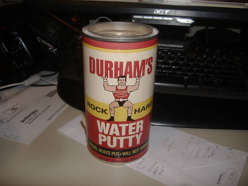

Sooooo it seems that a lot of you prefer the old Durham's to the new stuff on the block dispirit the fact you haven't tried it?? Seem fair.
BTW I've used and still use Durham's, since the late 1950's.
Here is a can from 10/2003 and yes it is still useable and I often add liquid latex to it. But that is another subject.
[ATTACH]18005[/ATTACH]

reible wrote:Sooooo it seems that a lot of you prefer the old Durham's to the new stuff on the block dispirit the fact you haven't tried it?? Seem fair.
I didn't read anywhere where any of us said that we were against the new stuff or wouldn't try it...
We were just saying that we liked the Durham's better than anything we have tried so far.
Most of the time I use very little wood filler and a can will usually last me for many years. If a joint will not fit close I will keep cutting until it does.
If I start reading that the new product is far superior to Durham's and can do things for me that Durham's can't then I may try the new stuff but see little reason to dash out and buy another product when I have what may be a lifetime supply of a product that I am satisfied with...
As an aside... A major blemish I would probably fill with stick shellac and a hot blade. As I said above, I use very very little wood filler 98% of the time and most of the time none.
