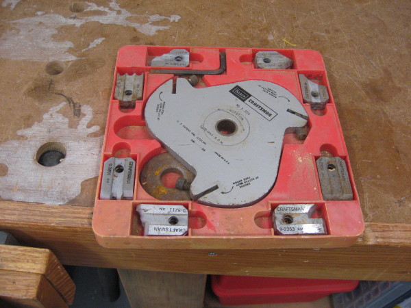

moulding head??????
[ATTACH]18096[/ATTACH]By moulding head cutter do you mean this thing??
I havent used this for long time. used to have
a sears table saw that i used it with. the first time
i started it up, wow what a noise.
now if you ran that thing at 10,000 rpm it had to have been
louder than an F-15 with both engines on afterburner......
I have done the same thing with jointer, then put bandsaw in place
and didnt check the speed........ sometimes us humans are not thinking.............[ATTACH]
[/ATTACH]
