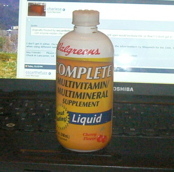

This 'plug' does not also provide the hose reduction feature of the SS version, but it is a 'GREEN' alternative with negligible cost(available due to other needs!).;)
[ATTACH]18076[/ATTACH]
dc3300 plug.jpg (83.53 KiB) Viewed 1936 times
According to the chart, the sum of the three ports is only 302CFM. We have lost 28CFM somewhere.:rolleyes:
