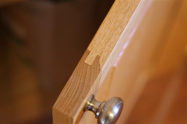

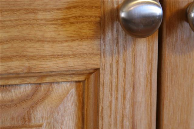

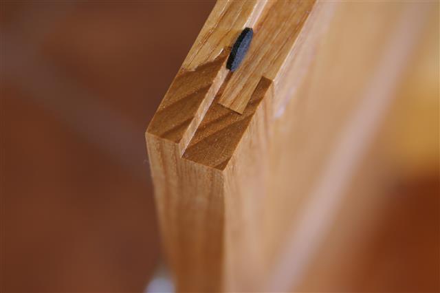

I have questions though as I have to make a raised panel door very similiar to what you are showing to cover a hole where our trash compactor came out.
Did you use the shaper function on the SS or did you you use a router?
Where did you get the bits? Can you post a close up of the panel detail and joint detail? where the frames come together?
Thanks

terrydowning wrote:Really great work Bud!!
Thanks
I used a router in my modified SS router table and a Freud 3-Bit set #97-210. I believe this set has been replaced by a newer, adjustable, set # 97-260.
My rail and stile bits are #99-261 and appear to be replaced by 99-761
My panel bit is 99-571
This one is of the upper corner of the door on the bookcase:
[ATTACH]20506[/ATTACH]
The next two are from the pantry. May be a little easier to see without the rabbet in the door. I used the same bit set on the pantry.
[ATTACH]20507[/ATTACH]
[ATTACH]20508[/ATTACH]
Doing a simple beveled panel is easy enough to do on the SS in table saw mode where the rails and stiles are basically a tongue and groove setup. I've got some links somewhere to some demos on how to do them that way if you need them.
