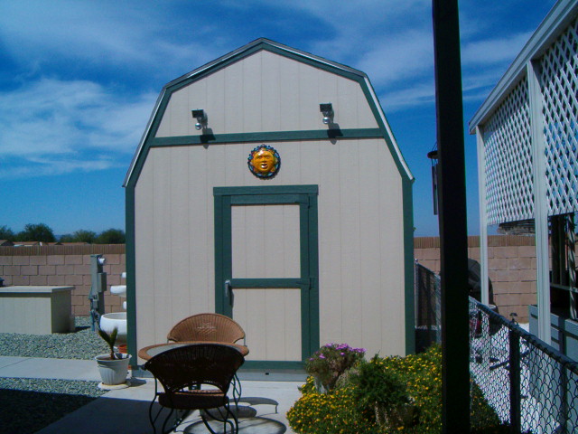

wre1692 - Now I understand the reason for your small building. At first I thought you may be on a wharf somewhere.
Since you are restricted to the 8X 10 footprint, would you be allowed to go up? Here's a picture of my storage shed. It happens to be 10' across the front and 8' deep. Would have gone larger but also have site restrictions. I find the added height of the shed wonderful for storage. This unit was prefab-ed by "Tuff Shed" http://www.tuffshed.com/locator.cfm?StateID=WA and put up in a couple of hours.
[ATTACH]801[/ATTACH]
- shed.jpg (113.95 KiB) Viewed 14878 times
