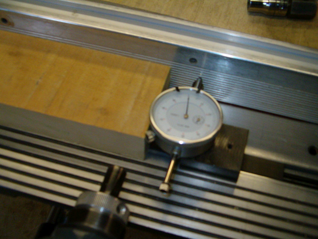

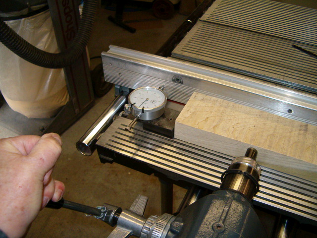

As promised, today I tried to make the 510 fence deflect while pushing with the quill. Photos included - -
I learned a lot while doing this! My 510 fence will deflect .030" at the outfeed end. Is order to do this test, I first set up the main table flush with the extension table (on the right side. With the locks locked and the extension table in place I was assured there would be no movement of the table. (or at least very minute) I set up the fence and made sure the outfeed clamp was snugged down. - Set a poplar board against the fence while the dial indicator was set to zero. I then extended the quill until the end face of the spindle pushed on the board. Then put on the pressure! I believe I was putting about 50 to 70 lbs pressure on the quill handle. Stopped there because didn't want to break the handle. Also this is much more pressure than I would give to a drill bit.
The Dial indicator moved outward from 0 to .70 - a distance of .030" This was repeated near the middle of the rip fence. This time the deflection was 0.018". This much deflection is not very much, but the fence does deflect a small amount. The deflection is caused by rotation of the clamp on the outfeed side.
Also need to say that I snugged down the out-feed clamp more than usual. (Not real tight, but a wrist twist on the socket extension) When releasing the fence from the main table, I had to pull upward on the outfeed side to allow the open camp to by-pass the table tube. Usually the clamp is not quite this tight.
Observations:
1) Usual use of the 510 Rip Fence for backup of workpiece in horizontal drilling with sharp drill bits, will present no issues, deflection is minor if the outfeed end is snugged.
2) For drilling a thru hole in a workpiece and having little (if any) tolerance at the far end - it would be best to both back up the fence with a clamped stiffener and use the miter gauge to assure a square drilling.
3) When drilling a long bore - it is possible and may be a good idea to drill from both ends - meeting in the middle. It is also possible to use the lathe for deep (long) boring.
3a) Another method of accomplishing this drilling job while using the horizontal boring method, would be to drill the thru hole prior to final shaping of the piece.
[ATTACH]799[/ATTACH]
[ATTACH]800[/ATTACH]
Observations:
