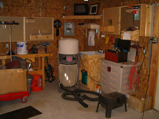

Great Stuff the brand name of a foaming sealant that comes in a pressurized can. Can be found at almost any hardware or big box store. My reference to Little Great Stuff was a typo, giving a capital L to "little".
Here's an old photo (prior to larger hood) that if enlarged, shows three of the leg bolts/screws covered with "Great Stuff". (the tan colored bumps).
