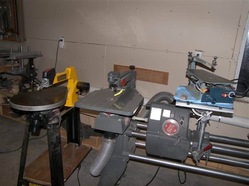

I'm finally getting back to the comparative review I promised last fall. Just after picking up the Shopsmith scroll saw it turned too cold to work in the unheated shop. The last few weekends have been nice, so I started the process and share my findings.
The saw on the far right is my 15” Delta I’ve had sense 1991. It had the original single speed motor on it till a half dozen years ago when I switched it out for the speed control and motor off a Ryobi 16”. That saw didn’t even last 10 hours when the blade clamp self-destructed. Variable speed made the Delta a good little saw again. Believe it or not, the Ryboi parts mated up perfectly and it runs extremely smooth.
I’ll cover the review over a couple of posts, over the next few days as I had Ulner nerve surgery last Friday and I’m not able to do much more then think about working in the shop for a while.

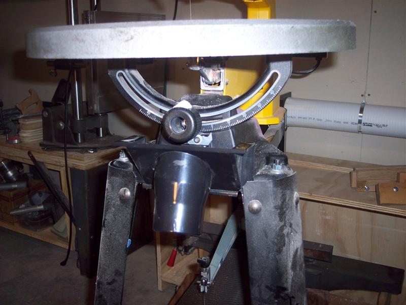

To make it as fair as possible, I had to do a few things to even up the two saws. The Dewalt has no dust collection, so I used a router fence port and wedged it between the leg frames. Usually I just bungee the end of a hose but this is pretty stable so I’m going to keep it there. [ATTACH]20716[/ATTACH]

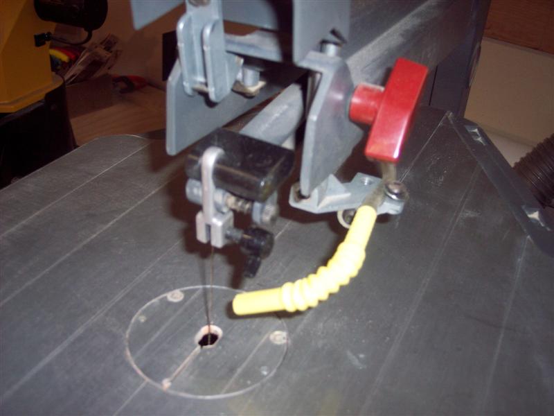

The Shopsmith had older style blade clamps so I picked up the up-grade clamps (from order to delivery was less than a week) and swiped one of the kids flex straws for the upper blade dust control. [ATTACH]20717[/ATTACH]
