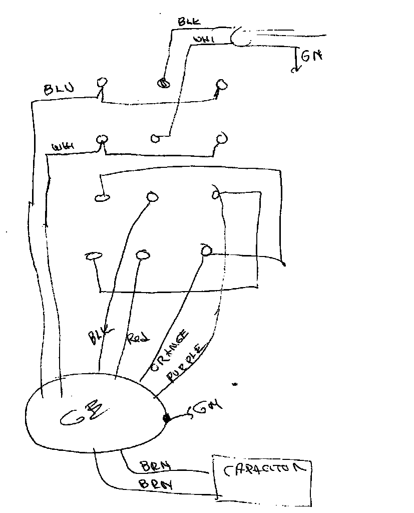

Crude, but should do.
[ATTACH]26749[/ATTACH]
Mark VII power switch
- mark VII 4PDT switch wiring.jpg (113.25 KiB) Viewed 1712 times
Re: Mark VII power switch
I got the chance to hook everything up this past weekend. Worked perfectly!! Thanks a lot for the help!
