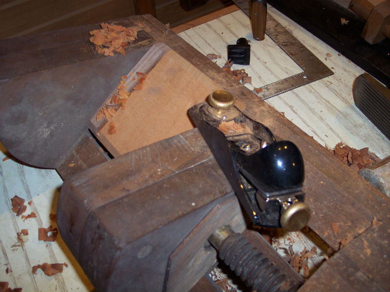

Dave, thanks.... feeling better today.... here is revealed the latest "gimmick." It's actually a very old "Miter Jack" I found in an antique store. After trying it for this tissue box, I realize these particular workpieces have a low enough aspect-ratio that they'd really be easier to do on the 45-tilted Shopsmith disc-sander (my normal technique). I didn't quite have enough 'meat' to guide my plane as well as this old jig could do with more conventional workpieces. So my bevels aren't perfect and I'm using gap-filling epoxy (my savior). Everything is a tad oversize and hopefully will look tidier when trimmed down later.judaspre1982 wrote:Hi Chris
Let us know what your new technique is after you get to try it out.
I will be using your bandsaw bevel cutting technique this weekend.
Looks like you've got a good start on your new tissue box. Hope you feel better.
Dave
Here's the jig in action:
[ATTACH]22487[/ATTACH]
Here's the initial glue of 2 joints (will do the last 2 after inserting the top piece yet to be made):
[ATTACH]22488[/ATTACH]

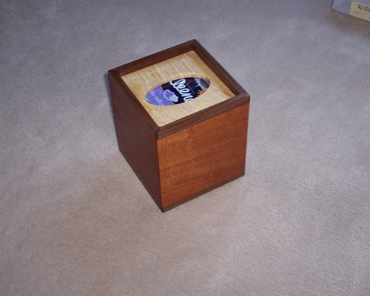

[ATTACH]22581[/ATTACH]
In the parlance of car paint-shops, it's now got a "5 foot finish," what with the unfilled mahogany, etc. Get closer than 5 ft, and it's not so great. But it'll do the job.
I used:
2 coats of Tru-Oil
1 coat of Shellawax (turning finish)
1 coat of JPW
Then
Washed hands with cherry pumice GoJo
Washed hands doing dishes for SWMBO
The box will be going to a Niece with her apartment just big enough to hold it....

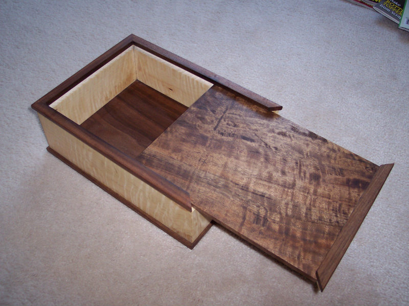

Similar Techniques used for a Gift Box

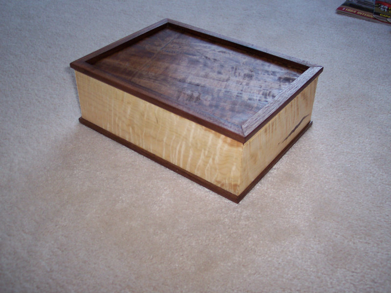

Believe it or not, when trying to buy some fairly unremarkable wood from an eBay seller, I was accidentally sent some top-notch figured maple. The seller and I came to terms so I could just keep the 'mistake' and avoid more shipping hassles.
Here is a gift-box made using similar techniques as the last tissue-box. For instance, gluing on the upper / lower trim pieces allowed me to (a.) effectively have more board dimension than I would have had, and (b.) cut dadoes with less fear of climb-cut incidents on my router table. I was just cutting rabbets on the edges of the maple and not dadoes.
I also had got some very figured walnut -- nice to look at from a distance, but full of grain-filling-needs if you look much closer.
[ATTACH]23143[/ATTACH]
[ATTACH]23144[/ATTACH]
- Gift Box Open.jpg (107.35 KiB) Viewed 1219 times
- Gift Box Closed.jpg (101.09 KiB) Viewed 1217 times
Chris
