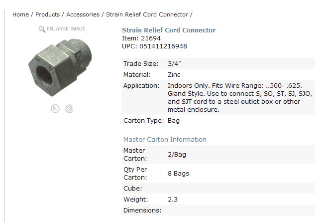

Would something like this work, though I don't know what size the hole for the cord is?
http://www.homedepot.com/h_d1/N-25ecodZ ... reId=10051
Our only choice locally is Home Depot or Lowes. Only thing that Lowes shows is strain reliefs for data cables, and the above is the only thing that shows for the local Home Depot. Any other store, I might as well order the precise part online and pay shipping because the gas spent to get to an Ace Hardware or an electrical supply place would be about the same as shipping.

Yes, but, you will have to greatly enlarge the hole to over an inch diameter. Those who have done a DIY PP upgrade can attest to the hardness of the motor pan. If you have any electrician friends, borrow a hole punch.(3/4" trade size) Make sure there is clearance for the nut inside.
IMHO this is an excellent choice.
P.S. I believe the 'gland' will accommodate varying size cords.
Well two sizes anyway![ATTACH]19026[/ATTACH]
P.P.S. There may not be enough room for the 3/4" version to clear the motor mounting bracket.
strain relief.jpg (30.2 KiB) Viewed 2568 times
I really prefer the Heyco strain relief for this particular application.
But, whatever you decide to use, buy the strain relief and check for clearance on the inside of the motor housing BEFORE you enlarge any hole.
