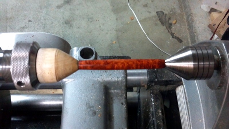

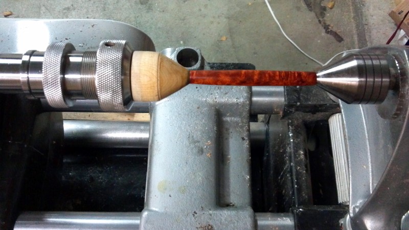

After getting the ends to the desired size turn the profile
[ATTACH]19333[/ATTACH]

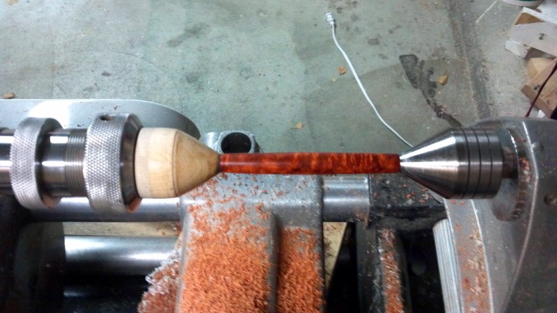

Now it is time for sanding. Since I used a slew I started at 320 grit and moved through the grits to 1000. Normally I'll stop at 600 but the burl on this blank just wanted a softer and finer grit.
Remember to stop the lathe and cross sand with each grit after sanding with the lathe on. This really makes the next grit easier. I also clean the blank with mineral spirits after each grit, to remove any stray bits that may still be on the blank.
Here it is sanded and ready to finish. Notice that I took the time to clean up my area. A clean work area is essential to a good finish.
[ATTACH]19334[/ATTACH]

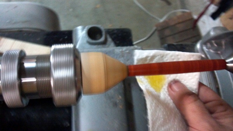

There are dozens of ways to finish a pen. For this pen I am starting with a Boiled Linseed Oil wipe down to remove any sanding stuff and dust, protect the wood and really make the grain pop.
Just a couple of drops is all you need. The BLO is the yellow on the paper towel.
[ATTACH]19335[/ATTACH]
BLO applied, ready for the next step
[ATTACH]19336[/ATTACH]

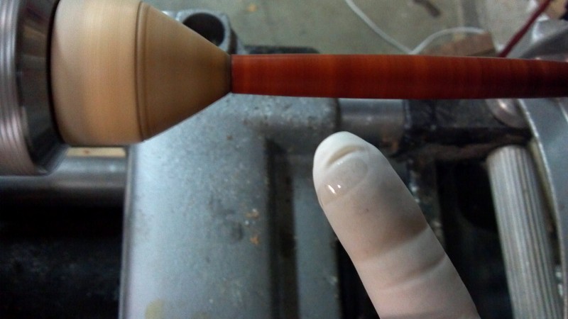

I'm choosing a CA fnish because it really shines up to a great gloss and provides the best wear protection possible. There are as many ways to apply a CA finish as there are wood turners. I have experimented with several and this is my latest method. Experiment with finishing and practice, there is no "best Way" to apply a finish, just what works for you. So, here is my process
With the lathe at a medium speed I put just a drop or two of thin CA on the tip of my gloved finger.

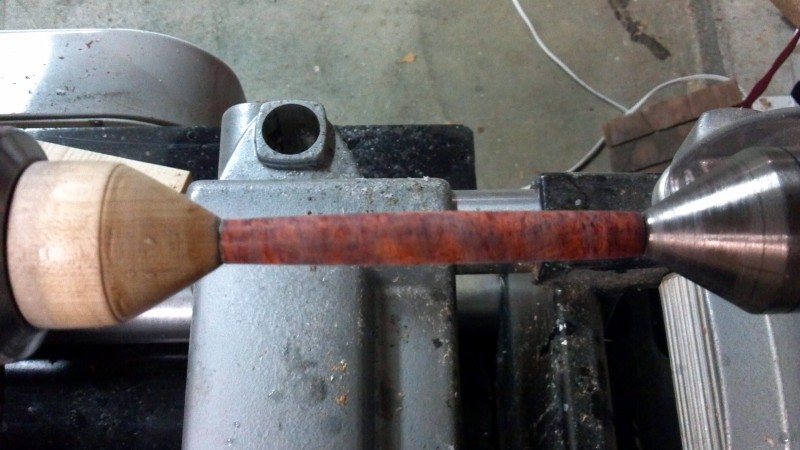

With just a drop or 2 of CA on my finger and the lathe spinning I slide my finger back and forth very quickly to spread the CA. I'll do this 2 or 3 times until I can see that I have a relatively even coat. That is 1 Application. I usually do 5 or 6 applications. Pay particular attention to the tackiness of the CA, if you feel that glove start to grab, pull away and wait for the application to dry. (less than a minute) The CA can and does occasionally grab that glove and tear it off of your hand. Don't be alarmed, It Happens, you just have top start over.
CA Applied It looks pretty good, starting to shine, but close inspection reveals small ridges and imperfections
[ATTACH]19341[/ATTACH]

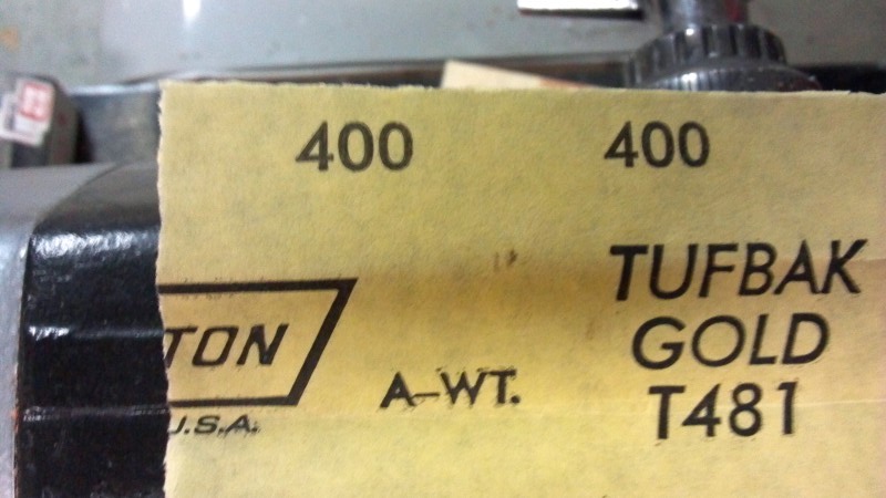

The secret to a good final product is the final sanding and polishing.
I start with 400 Grit wet/dry and DRY sand to "Level" the surface of the finish.
[ATTACH]19342[/ATTACH]
The easiest way to tell the surface is level is the lack of reflection.
This looks pretty good. If there were any noticeably shiny spots, I would continue with the 400 until it get to here. Don't for get to cross sand.
[ATTACH]19343[/ATTACH]

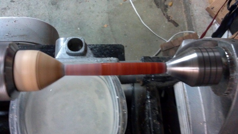

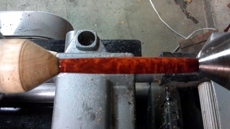

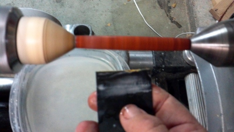

Now wet sanding can begin I wet sand with 600 and 800 grit.
wet down the blank and clean off the residue from the 400
[ATTACH]19344[/ATTACH]
Note the white slurry on the 800 grit sand paper, this is good. If the the slurry is the same color as the wood, then you have sanded through the CA and you're sanding wood. It really doesn't take mush time or effort, a few swipes with each grit, stop the lathe, cross sand.
[ATTACH]19345[/ATTACH]

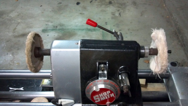

I mentioned in the previous post that stop sanding at 800. Many people move into the Micromesh up to the 1200 grit world. But I choose to buff instead. In case you didn't now it, the SS makes a great buffer.
[ATTACH]19346[/ATTACH]
Buffing wheels and compound are much cheaper than disposable sandpaper a set of wheels will last for years as will a stick of compound. By far this is the most cost effective way of getting a great finish.
The left wheel is a stitched cotton wheel loaded with Tripoli Compound (This is why I stop sanding at 800 beyond that and the tripoli is going backward.)
The right wheel is loose flannel loaded with White Diamond. I have another flannel wheel loaded with a blue plastic polishing compound.
Start buffing on the top of the wheel pushing your work away from you into the direction of the wheel, this is called a "Cutting" stroke. This what will remove the scratches from the previous grit.
Next move to the bottom of the wheel again pushing the product away from you (with the direction of the wheel. This is called a "Color" stroke it removes the compound applied during the cut stroke and brings up the shine. Move to the next finer wheel, cut and color, last wheel, cut and color, buffing only takes a minute or two.

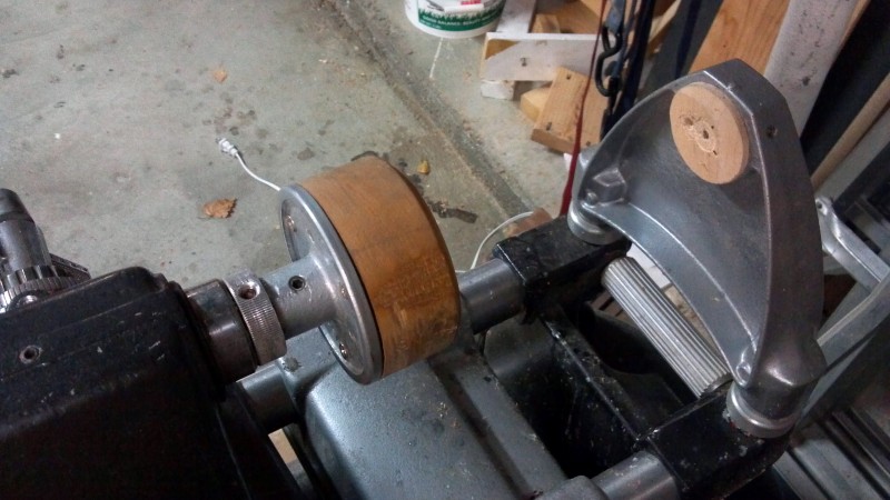

Instead of buying a pen press, I just use my Shopsmith.
I use my scrap block faceplate/hand wheel as an anvil on the end of the quill and I turned a cutoff to serve as an anvil in the tailstock.
[ATTACH]19347[/ATTACH]

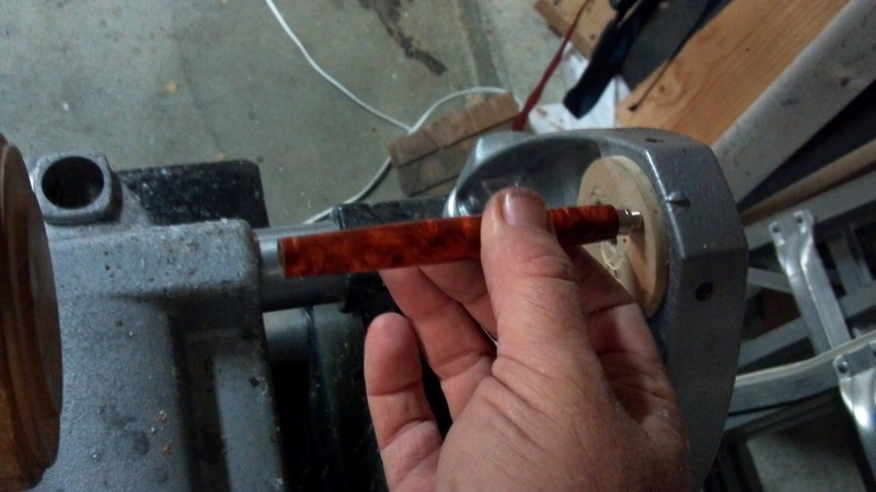

Pressing in the Nosecone coupler. The camera hand will advance the quill and engage the pen body and press the coupler into the brass tube inside the pen body.
[ATTACH]19348[/ATTACH]
Pressing on the click assembly and clip. Note, this particular kit has a pressing tool that covers the click mechanism allowing it to be pressed on. RTFM!!
[ATTACH]19349[/ATTACH]

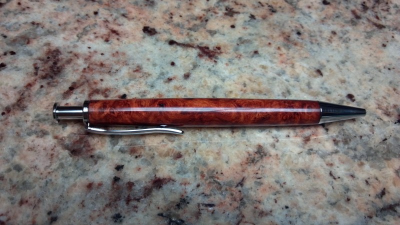

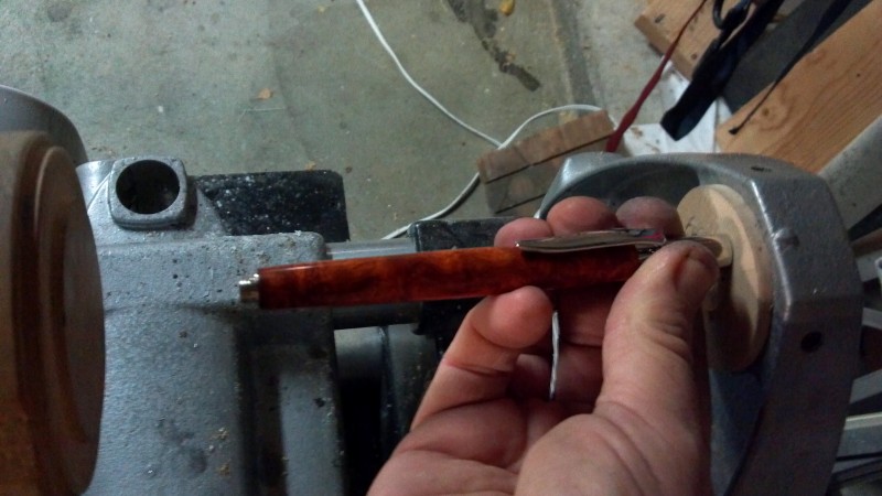

Let's see how it looks!
[ATTACH]19350[/ATTACH]
Not bad if I do say!
