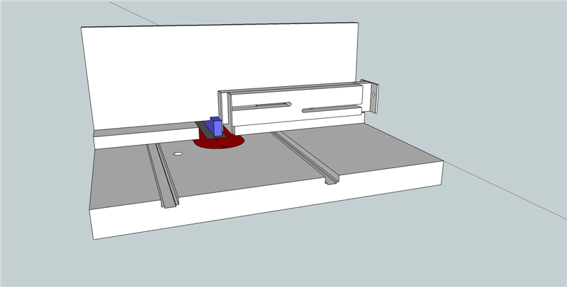

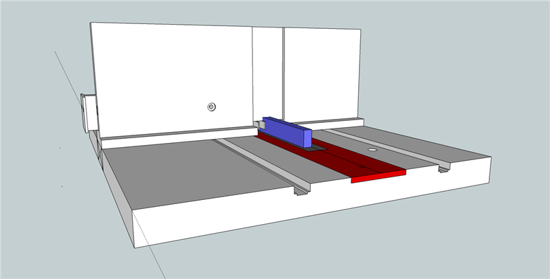

This project is simple in concept but has been a real chore to put together in Sketchup. I thought I knew most of the basic but I was so wrong.
I do have all the parts defined and am now about ready to begin construction. When that finally happens, I'll know just how much I really understand (both Sketchup and the Jig).
[ATTACH]19727[/ATTACH]
[ATTACH]19728[/ATTACH]
NOTE: The blue block is intended to represent the blades' position. The backer board is also not shown.
Conceptually, there are no differences depicted here from previous postings.

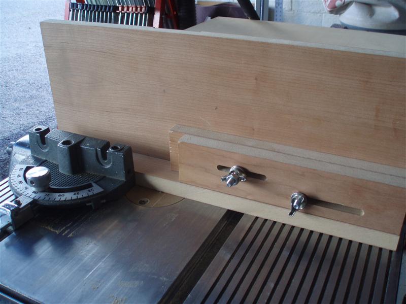

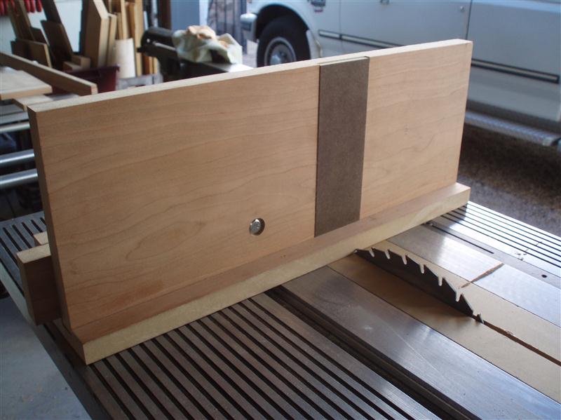

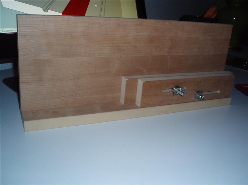

A concept very slowly comes into reality. Now that I have it where I can touch and feel, I am not sure that I am going to like it. I must make a trip to the hardware store. I need some hardware before I can complete the job.
I still need knobs and some small metal pieces to fabricate some parts.

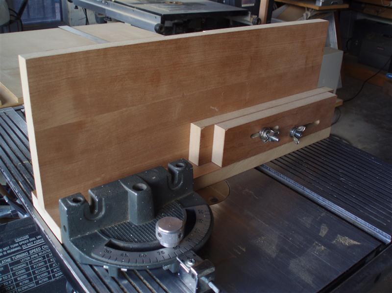

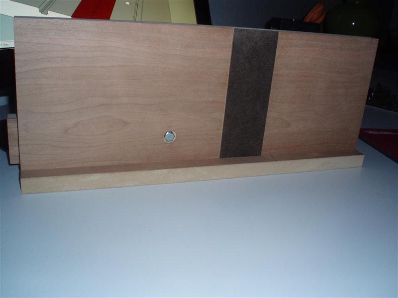

I was going to equip this one with two miter slot runners but it would be also be very easy to attach it to a miter gauge fence.
Thanks for the offer and any reference documentation that you might have. The more input we utilize, the more likely we are to come up with a good solution.
Here are some pictures that I took as a result of your input, Geo. You can see that with better timing and some conceptual changes, the miter gauge or gauges could be utilized.
[ATTACH]19756[/ATTACH]
[ATTACH]19757[/ATTACH]
[ATTACH]19758[/ATTACH]
Until I took these pictures, I did not realize that I made this whole thing 1/2" shorter than the plan calls for. It was suppose to be the same width as the main table.
