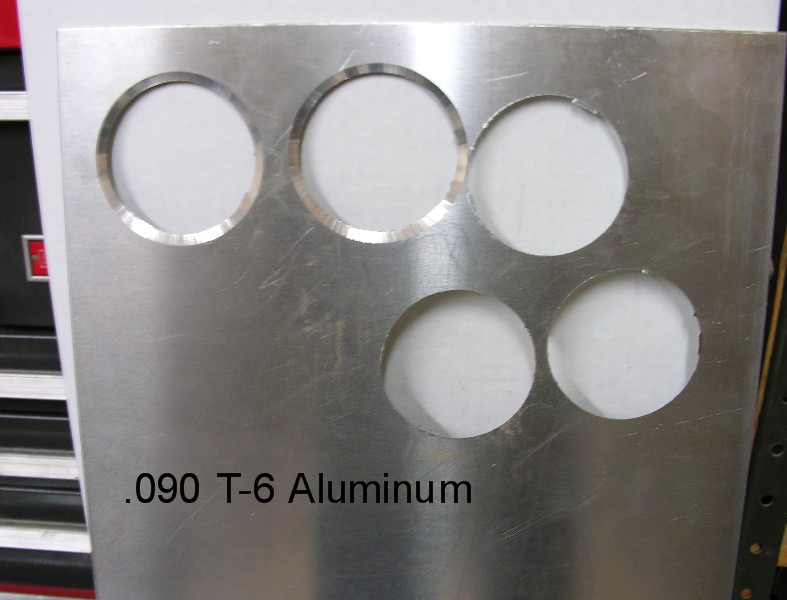

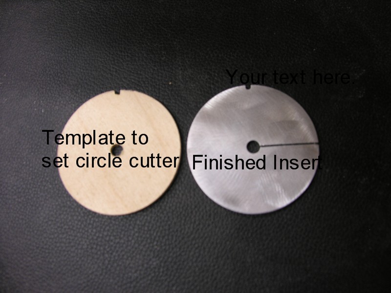

I make my own for the Delta and Shopsmith as the aluminum ones can be a bit hard to find at times. I am not sure you need a template to setup the circle cutter, but I seem to have a template for about everything I do.
ldh
[ATTACH]19962[/ATTACH]
[ATTACH]19963[/ATTACH]
