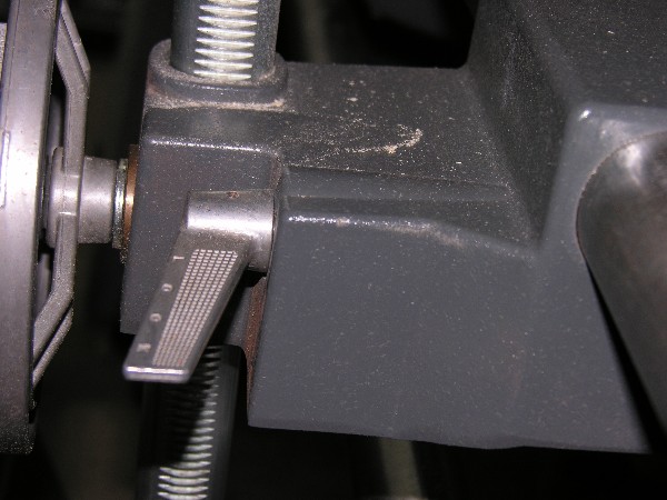

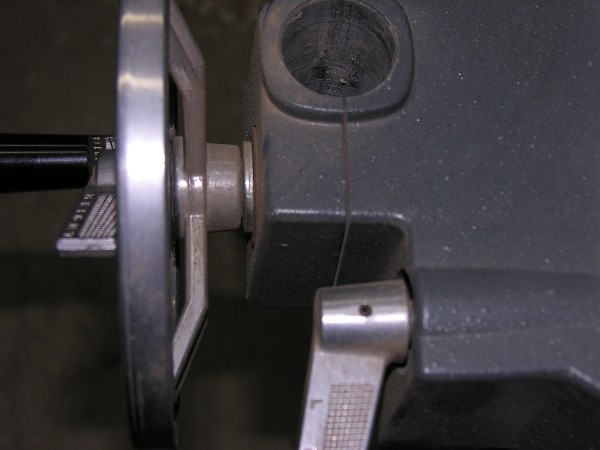

I recently acquired a 92 model 510 and a upgrade 520 unit and I noticed a little difference in the carriages. The shopsmith replacement number is the same for both the 510 and 520 carriage and yet two different methods are used to secure the table legs. I added the pics so that you can see the difference. Do any of you folks know about the difference?

Hi Idh,
I do see the split in the "510" carriage versus the no split in the "520". Sometimes manufacturing methods or techniques change. I would think that the parts are interchangeable even though they are slightly different. It makes me wonder; however, are all of the components that make up a new Mark V actually MADE in the USA? Also, does the 520 upgrade come with a new carriage?

Tim,
I think the 520 is an upgrade from a 510R, so the carriage may be from the original 510. The 510 was born a 510. I have always used a 500 so I don't know much about the 510 or 520. I became interested in the 510 and 520 after reading all the posts from folks that have them. I just happened to be waiting in the weeds at the right time and purchased both at a very reasonable price. I have a winter shop and a summer shop so they both will have a kind and loving home.

Post by solicitr »
My brand-new 520 upgrade has the split carriage, so it's apparently not a 510 thing (nor should it be, logically). Perhaps SS uses two different suppliers? Or was it a design change, with old-style and new-style parts jumbled together on the shelf? (this happens a lot in manufacturing, as geekish students of vintage guitars quickly learn).
If the solid carriage is effectively the same as that in the 500, it strikes me as a weak design, since nothing holds the elevetion except the teeth in the locked pinions. The split carriage solidly clamps the tubes.

Bill,
Thanks for the good information. I think I will swap the 510 carriage with the split and put it on the 520. The 520 upgrade must have been an earlier version of the carriage. I might as well make the 520 as new as possible.
One has the C head and the other has the B head from 89. Both run well with seemingly little wear.

IDH
Just adding my .02 cents worth to this topic. I have only owned a 510 which was manufactured in Sept of 1993 and it has the split in the carriage that you are talking about. I have since upgraded it to a 520 after seeing how much better the fence/rail system worked while at a TA. As for getting an upgrade carriage, that only comes with a package going from a 500 to a 510 or 520.
