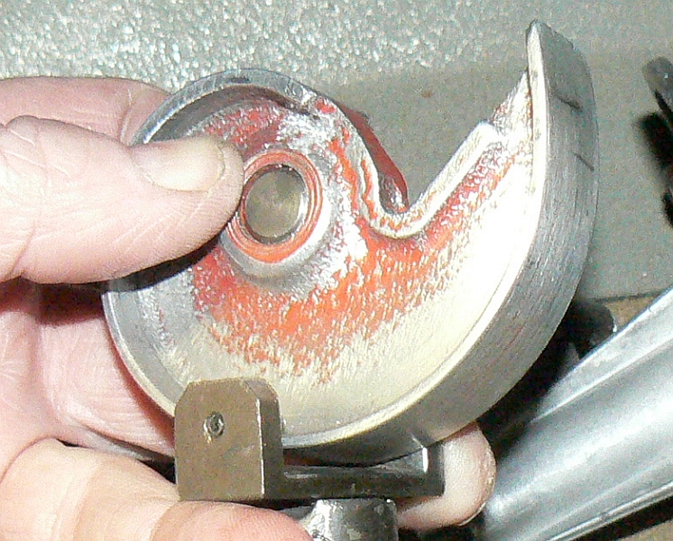

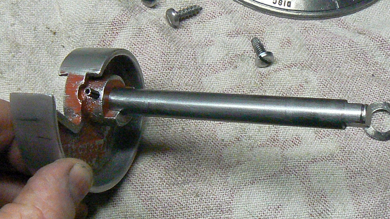

The Reeves drive part of the speed control is essentially the same as the Mark 5/V, but the control is different. A cam replaces the pork chop etc. and a large knob replaces the crank. The original had a plastic cam that was its major weak link(many melted). This one had a third party cast aluminum cam. Still does!;) Notice the 'different' screw. Gotta make sure it goes in the hole already boogered by it.:eek:
speed control 1.jpg (446.72 KiB) Viewed 4937 times
[ATTACH]20421[/ATTACH]
The cam is secured to the shaft by a tension pin. The shaft may be positioned either of two ways(it does not matter which since the hole and shaft flats are not offset). The cam hub notch faces the shaft. The pin is driven flush.

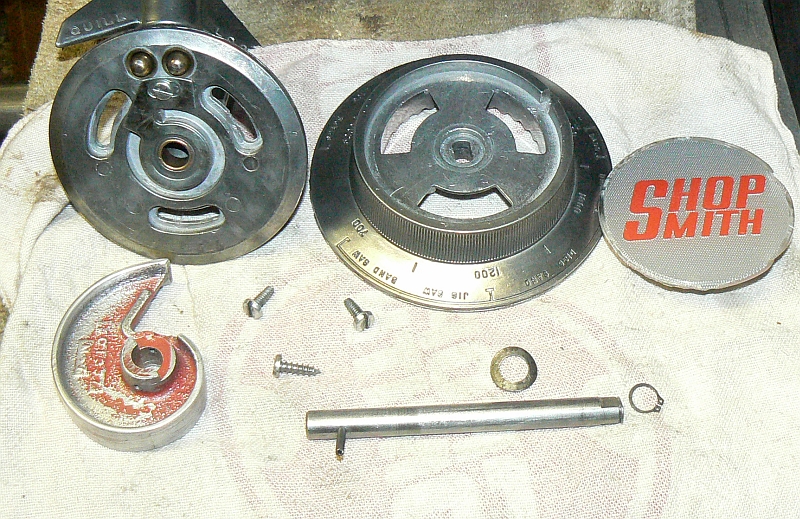

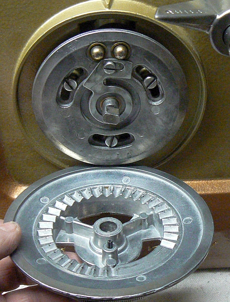

Now for an explanation of how this control works.
The 'base' has two 'bullet' spring loaded detents(brass colored thingeys near the top). The knob has 29 'grooves' around the center. The detents are spaced two grooves apart. Normally the two detents are both in grooves, but at the ends of the grooves, the knob will move one more groove by having only one detent in the 'next to last groove'. This creates 30 distinct detented positions.
The three mounting screws are in curved slots. The base can be positioned for slow speed setting by rotating the base.
There is pin on the knob(6 o'clock in the pix) that rides in a groove in the base. At the top end of that groove is an adjustable stop. This is in essence a high speed stop adjustment.
speed control 5.jpg (301.52 KiB) Viewed 4928 times
[ATTACH]20425[/ATTACH]

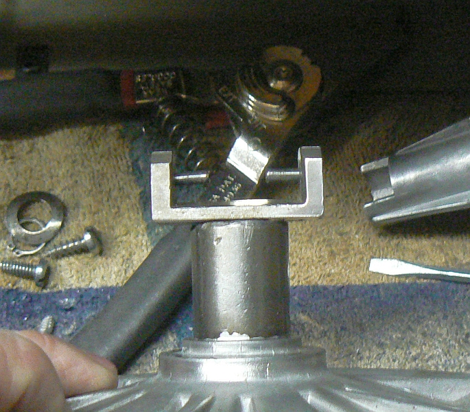

Another thingey not on a Mark 5/V is the carriage to headstock connecting rod. The headstock has a clamp that registers on the rod.
[ATTACH]20437[/ATTACH]
A tension pin stop and a shaft guide are pushed into holes in the front of the headstock from the inside.
[ATTACH]20438[/ATTACH]
The control rod is inserted into its hole in the headstock, then connected to the latch and the latch is placed onto the shaft guide.
[ATTACH]20439[/ATTACH]
The screw, washer and lock nut loosely secure the latch.
The rounded end of a spring is inserted into the control rod hole in the latch.
[ATTACH]20440[/ATTACH]
This pix is wrong, see below.

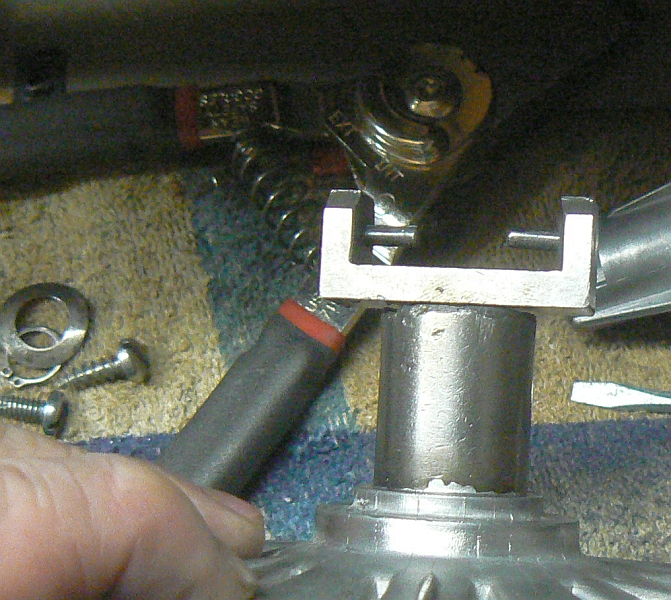

Posted: Fri Mar 01, 2013 1:49 am
by JPG
[ATTACH]20441[/ATTACH]The other end of the spring sits in a small 'well'. Looks weird, but works quite well.
Pesky detail, but, the spring is not inserted properly in the last two pix. See below.
And the tinnerman nuts get us prepared for mating to the motor pan etc.
[attach]20442[/attach]
The operation of the clamp will be come clearer when the carriage is done.
"below"
The spring goes to the hole above the linkage, not below as shown(wrong) above. In the two pix below the spring is on the opposite side of the linkage(sorry the pix are reversed, but hopefully you can see the difference).
[ATTACH]23713[/ATTACH]
[ATTACH]23714[/ATTACH]
In spite of my previous comment re its working well, this makes it better!

Mark VII speed control revisited
Posted: Wed Mar 06, 2013 8:57 pm
by JPG
As I mentioned above, the speed control knob has become way too stiff(difficult to turn).
So I revisited it and gained a better understanding of some 'details'.

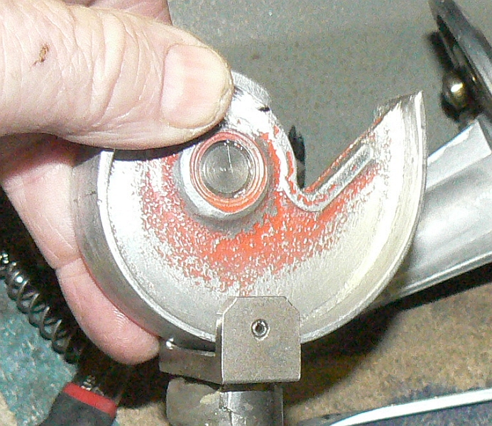

The slow/fast extremes are limited by some simple 'details'. The cam cannot push the control sheave any further than its very end will push it, but the sheave will bottom out against the idler sheave before that occurs(even though the idler sheave can also move on the shaft). The cam follower is limited in the other direction(fast) by its interfering with the control shaft.
The control knob has another 'set' of details. The indications around the dial are fixed relative to that 'stop' pin on the back side that rides in a groove. That groove has a 'slow' end that limits dial movement. The detent notches are also fixed relative to them. So slow speed adjustment consists of merely positioning the dial to the slow end of the groove, and rotating the base to align the pointer with '700'. The detents will more or less self position. After securing the base, the high speed stop can be 'adjusted. I believe it only serves as a way to make the stop coincide with the last detented position.

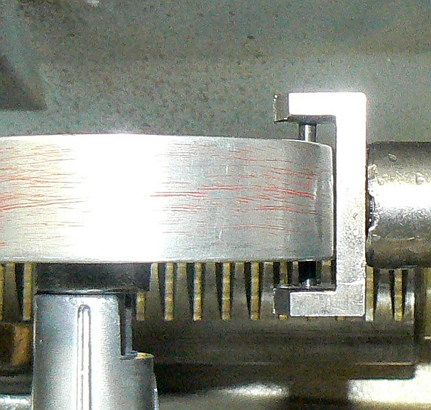

Also the cam follower has details that I missed earlier. The major non-symmetrical feature is a sloped shape that I missed earlier.
The edge is narrower on one side -
cam follower 1.jpg (402.13 KiB) Viewed 4873 times
[ATTACH]20516[/ATTACH]
than the opposite side.
cam follower 2.jpg (391.11 KiB) Viewed 4872 times
[ATTACH]20517[/ATTACH]

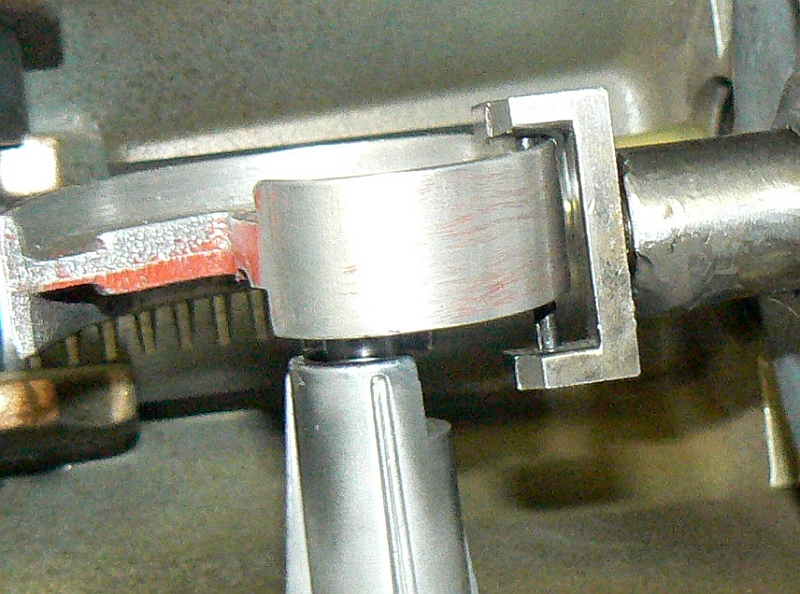

It needs to be positioned to the cam so that the slope helps the cam move the follower. EDIT: The skinny side provides provides the same clearance as the fat side since the cam diameter varies as it passes through the follower.
cam follower 3.jpg (403.68 KiB) Viewed 4870 times
[ATTACH]20518[/ATTACH]
This is needed most when the cam is pushing against the follower.
cam follower 4.jpg (430.92 KiB) Viewed 4875 times
[ATTACH]20519[/ATTACH]
Finally the spring washer works best where I found it(between the knob and the base).
EDIT: Notice the skinny side faces the larger diameter direction of the cam.
