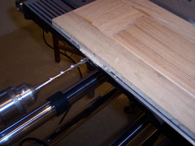

I took the front panel, test-fitted it, and used the lock-plungers in the chest to mark its upper edge for two socket holes. Then I horizontal-bored those holes. Simple, right!?
[ATTACH]20315[/ATTACH]

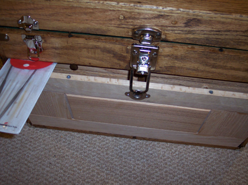

Now we see (but not hear the cussing) as the holes, now with metal inserts from ACE hardware, are 'adjusted' with files and such. Otherwise I couldn't get the stuff to shut properly:
[ATTACH]20316[/ATTACH]

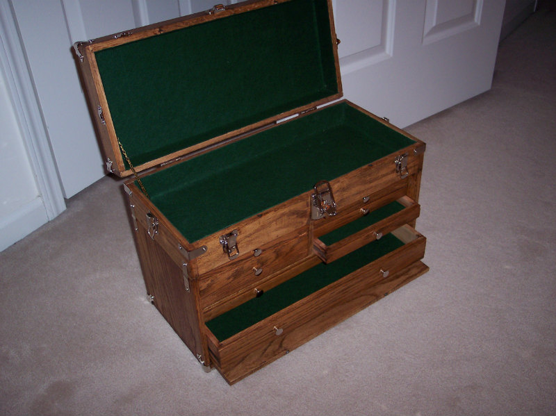

I also had to take care on the front-panel dimensioning to be sure it could actually slide/stow inside the chest cavity as well. This made it have to be a little narrower than I'd otherwise have chosen. I also had fitted a few knobs on the drawers, just to be sure the front panel would clear them adequately. Boy, the new knobs are from Gerstner & Sons (even though it's a no-name tool chest), and they exude weight and quality....
[ATTACH]20318[/ATTACH]

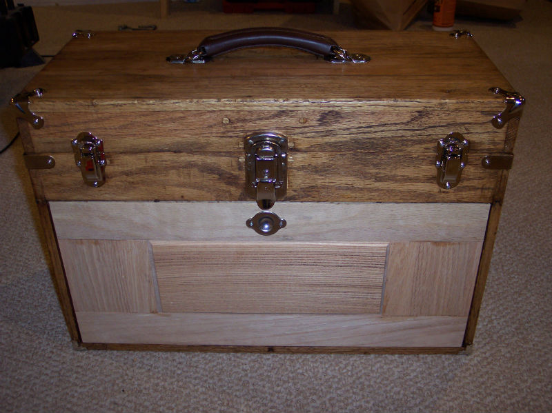

Now the front panel will finally lock into place as intended:
[ATTACH]20317[/ATTACH]

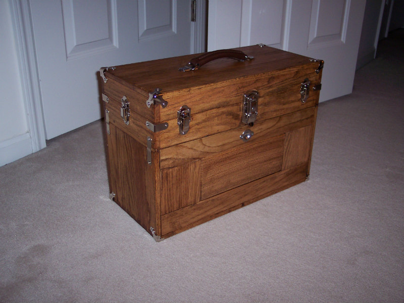

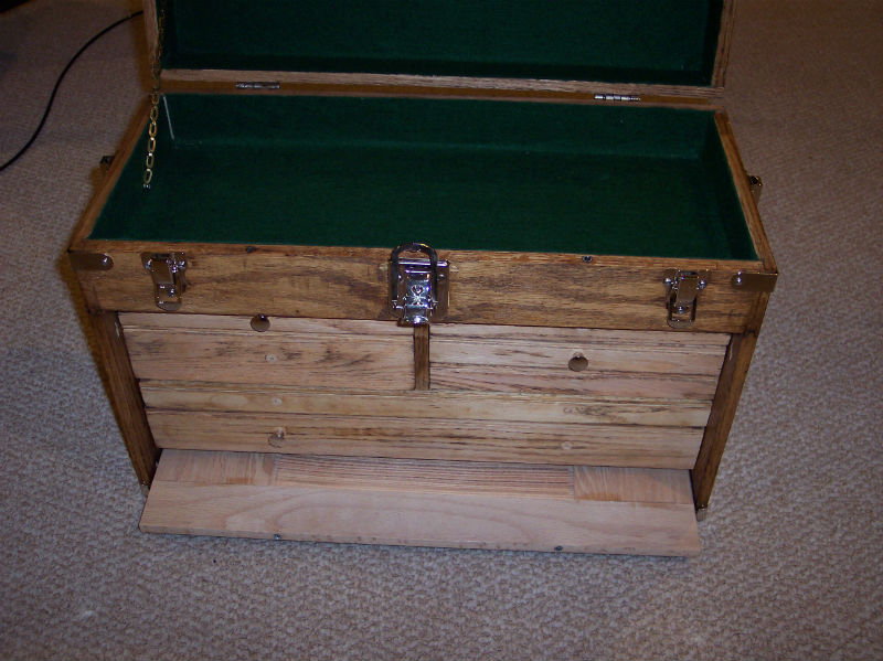

Reassembled at Last
Here it is, basically done! Now it looks just like an $89 Harbor Freight unit, but it has a nicer heft and resonance of a solid wood product. Nephew will receive it when I visit him in March.

Nothing shabby about your eye candy!
I wouldn't compare that to the HFT. Even in pictures on a computer you can tell they aren't in the same class. Very nice.nuhobby wrote:Here it is, basically done! Now it looks just like an $89 Harbor Freight unit, but it has a nicer heft and resonance of a solid wood product. Nephew will receive it when I visit him in March.
[ATTACH]20363[/ATTACH]
[ATTACH]20364[/ATTACH]
Where I live old machinist tool boxes are a big deal. $300 total investment is doing real well for a restoration, I wouldn't call that illogical at all. Besides the fact that restorations mean way more than money.
