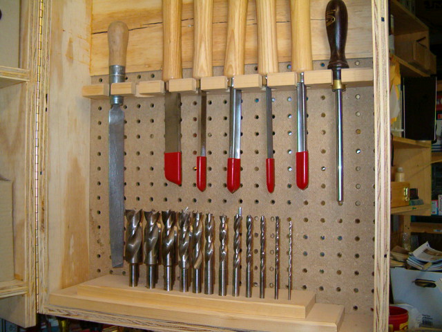

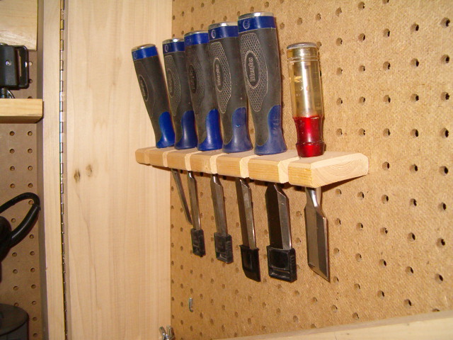

Oh now I see. I drilled a hole for the shank to fit in and the slot is only wide enough for the chisel to be turned sideways to come out. Maybe if you make
the opening in the front piece to be wider ah deeper dado would make them come out easier? just guessing other wise yours looks real nice.

dusty wrote:Yeah, that works but the chisels fall out very easily. I don't believe I cut the notches like I should have.
[ATTACH]20510[/ATTACH]
Ah yes I agree with Dusty on this one. When I looked at the string of chisels my first thought was "no guard=falling chisels" I keep mine in the wooden box they came in. they lay flat and I never get cut until I begin using them:D:mad: Jim

A counterbore for the bottom of the handles to nest into will 'fix' the falling problem.fjimp wrote:Ah yes I agree with Dusty on this one. When I looked at the string of chisels my first thought was "no guard=falling chisels" I keep mine in the wooden box they came in. they lay flat and I never get cut until I begin using them:D:mad: Jim

Notches are O.K. If you would do a counter bore to allow the tang, or sloped portion of the handle to lock into the hole, they won't fall or slip out.
[ATTACH]20511[/ATTACH]
[ATTACH]20512[/ATTACH]
