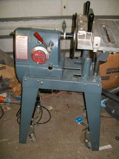

The scroll saw and jig saw will operate in either direction. They convert rotary action to up and down action. The MINI uses 25 5/8" way tubes and 26 3/8" bench tubes. You cut the bench tube in half and cut the way tube twice in the middle.
Having seen recent good pictures of the Crafter Station, I have made a Crafter Station Upgrade for the MINI that will allow the full capability of the Crafter Station with the added advance of having the full 750 to 5200 RPM speed range of the MINI headstock. I used the 500 main table and modified carriage that fits in the SPT mounting holes. It makes a nice joiner and planer knife sharping setup as the main table can be tilted for different knife angles. It also makes a nice wide extension table for the 500 machines that is easy to raise and lower along with being able to be tilted. This modification provides much greater capability and more functions than the Mark V Power Station shown below that I just assemblied.
[ATTACH]22530[/ATTACH]
