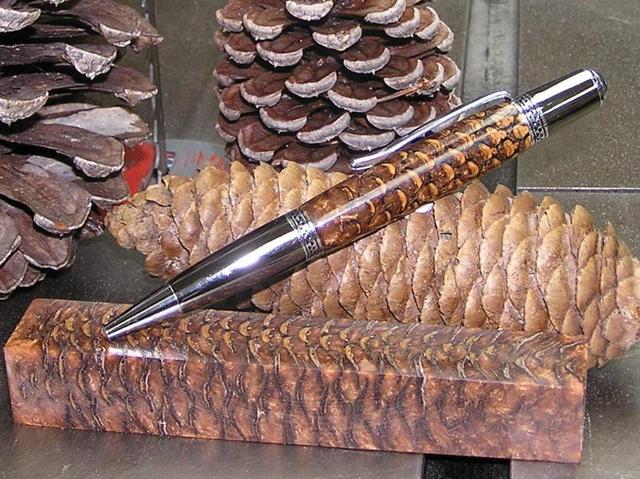

The pinecones shown above are not large enough for pens without casting in resin. The best would be "Coulter" or "Digger" pinecones from southern California. You can only get one pinecone in a large USPS flat rate box. The second best would be Afghan or Southern Yellow Pine which is what I use. I pick them up at a rest area along I-26 outside of Columbia, SC on my way to Florida. The cones must be dry for turning, even if casting in resin. For corncob pens use the smallest diameter cobs that you can find. If you can find someone that raises popcorn that would be great.

bettyt44720 wrote:The pinecones shown above are not large enough for pens without casting in resin. The best would be "Coulter" or "Digger" pinecones from southern California. You can only get one pinecone in a large USPS flat rate box. The second best would be Afghan or Southern Yellow Pine which is what I use. I pick them up at a rest area along I-26 outside of Columbia, SC on my way to Florida. The cones must be dry for turning, even if casting in resin. For corncob pens use the smallest diameter cobs that you can find. If you can find someone that raises popcorn that would be great.
Those are some beautiful examples and interesting info regarding use of corncob.
the third photo in bettyt44720's post showed a beautiful pen, a squared pen blank and a long cone laying on the table. That cone is a spruce cone. The two upright cones are pine cones.
Question - was the pen in that photo made from a spruce cone?
