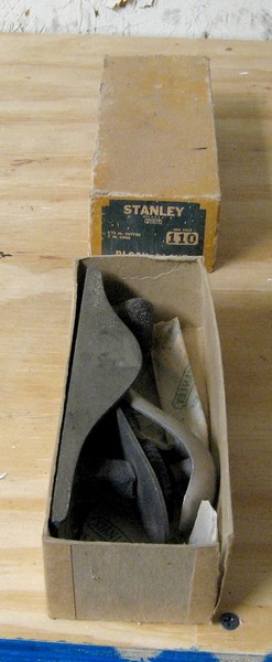

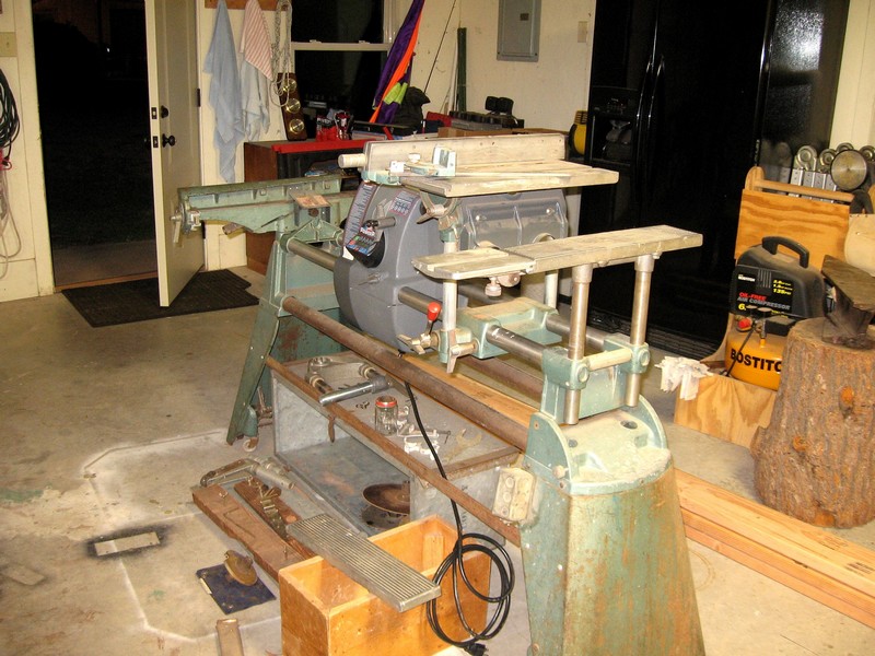

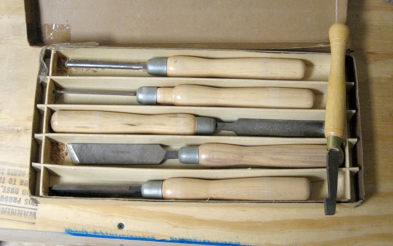

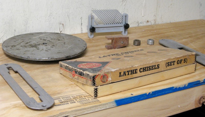

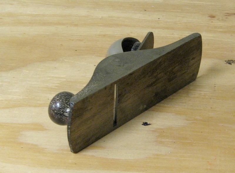

Since the previous pictures couldn't be blown up with any clarity, I went out and took some more pictures of the SS I have. (Until I figure out how to imbed them where I want them, you'll have to be satisfied with the attachments.) I also included pictures of a box that Pop had that I previously hadn't gone through. Lo and behold the treasures I found: push blocks, a featherboard, things for the lathe, some type of angle guide I'm not sure where it goes, a box of SS lathe chisels, etc. If anyone can clue me in on these things, it would be a great help!
I also found a Stanley 110 Block plane still in its original box! Used, of course, but still a good tool.

A Stanley 110 is a great block plane and that one will be a beauty and a joy to use when cleaned up and fettled. An afternoon with some 220 grit to flatten and clean the sole, and then sharpen the blade. Clean off all the dust and dirt. Good to go. A good sharp block plane is an essential woodworking tool IMHO.
Terry
