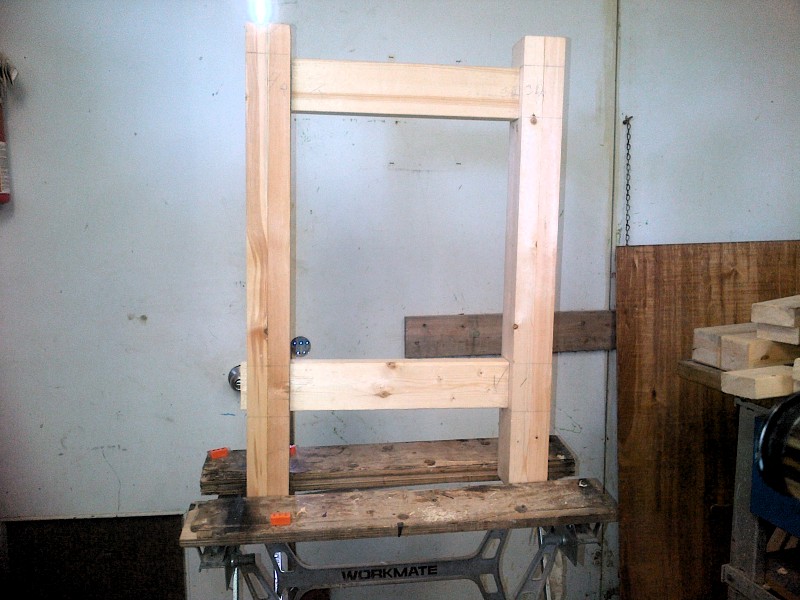

First pair of legs assembled, (not glued yet).

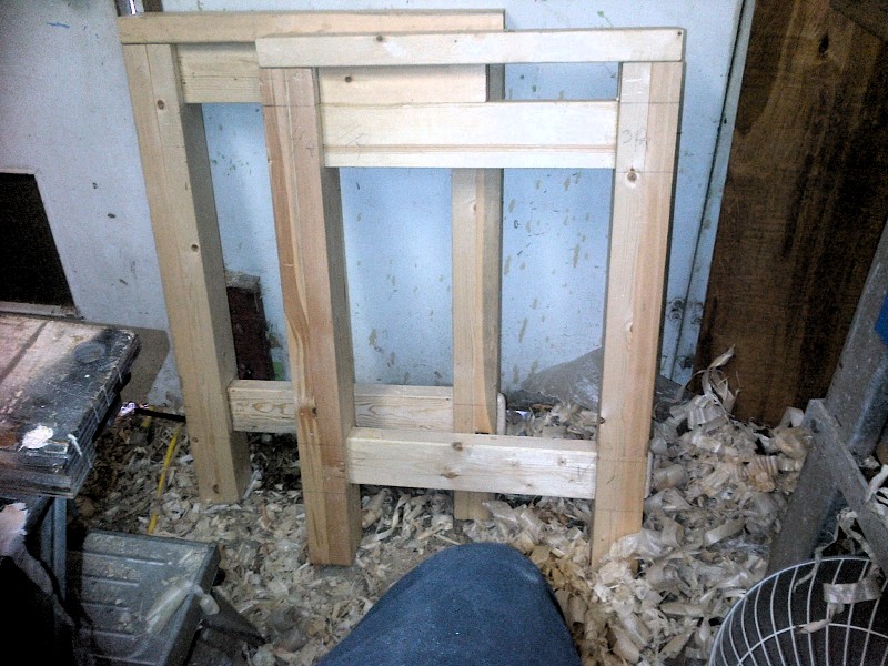

Good progress today, both leg assemblies finished and glued:).

Look Good!rpd wrote:Good progress today, both leg assemblies finished and glued:).
[ATTACH]21183[/ATTACH]
Ya saving the curly stuff for fire starter?:D
No, but it helps cushion the tools when I knock themJPG40504 wrote:Look Good!

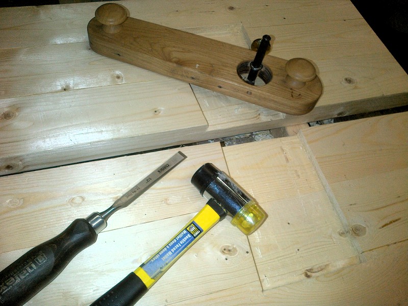

Today I chopped the housing dado’s in the aprons.
[ATTACH]21225[/ATTACH]
Red, note the shavings have gone to the compost pile.

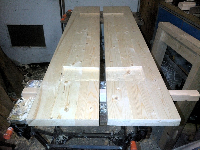

And a closeup.
[ATTACH]21226[/ATTACH]
The end is in sight, a couple more dado's on the well board and some shaping on the well board ends and then I can start assembly.
edit- a review of the plans shows the aprons legs and top are assembled and then the well board is fitted. Amazing what a nights sleep can do for clarity of thought.

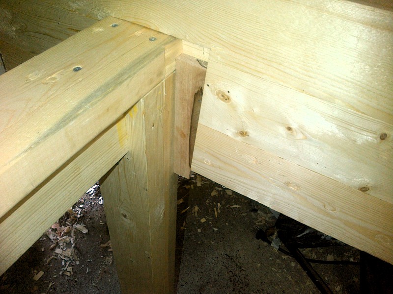

A good morning in the shop. I got the wedges cut and fitted in the aprons.
[ATTACH]21231[/ATTACH]

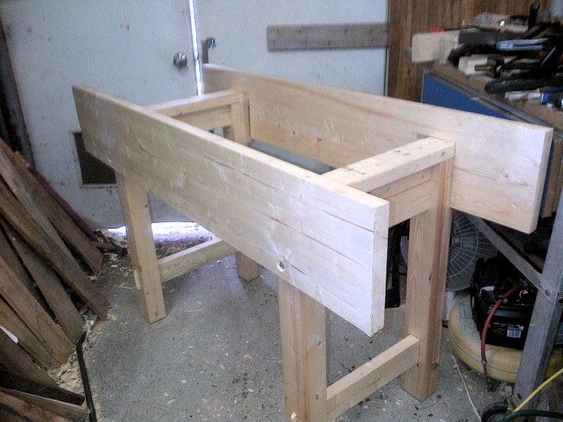

And the aprons bolted to the legs. At this point it is already very solid and rigid.
[ATTACH]21232[/ATTACH]

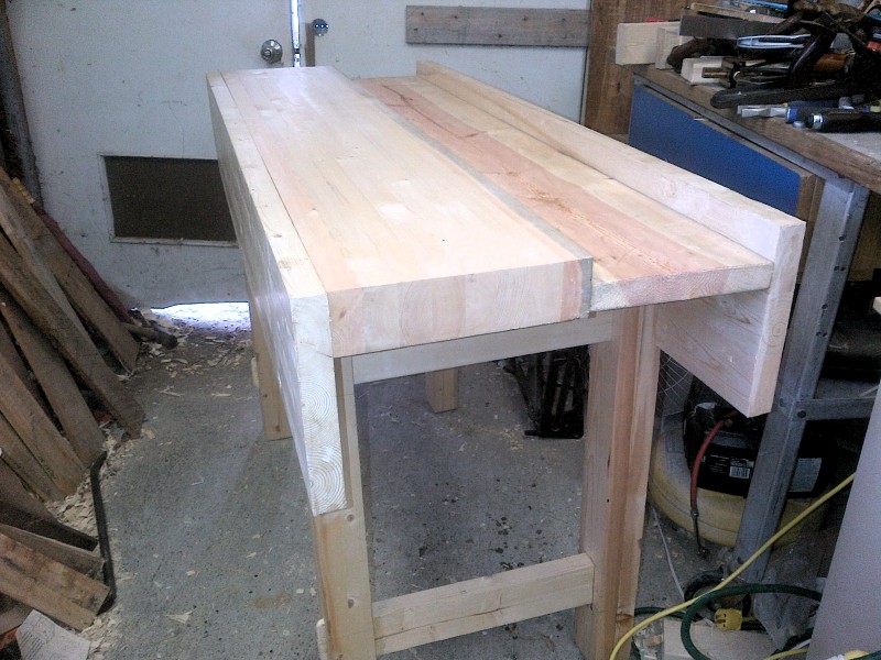

Lots happening last weekend but I have made some progress.
The top and well board are glued to the aprons and screwed to the bearers. The ends were re cut so everything lines up properly The aprons are planed level with the top and the top and aprons are are sanded.
[ATTACH]21339[/ATTACH]
Next will be finishing with tung oil and fitting vises.

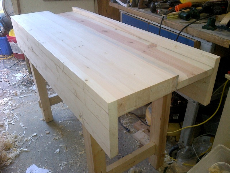

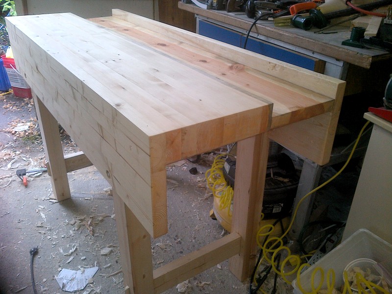

Slow progress since last post. The top and aprons are sanded and finished with two coats of Tung oil and a coat of wax.
[ATTACH]21467[/ATTACH]

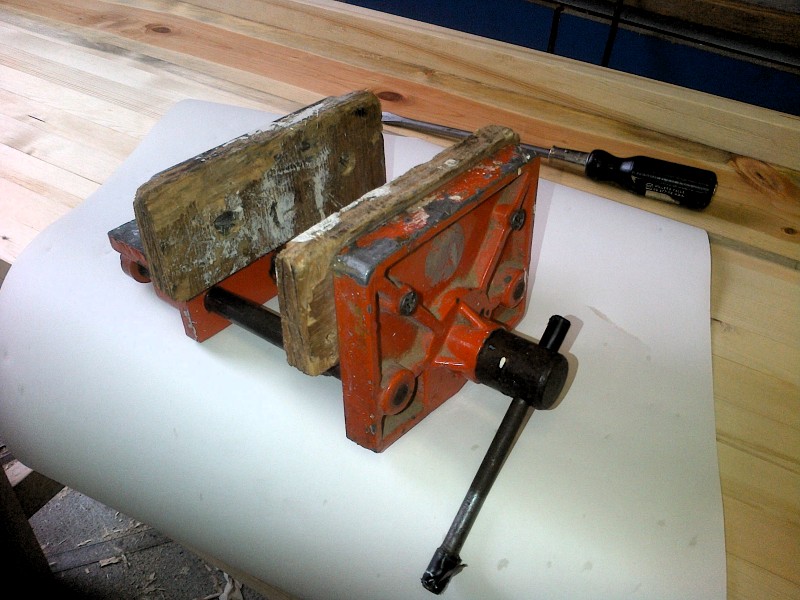

I had an old vise that I inherited from my father in law. (before)
[ATTACH]21468[/ATTACH]
Not a great vise but it will do till I can afford something better.

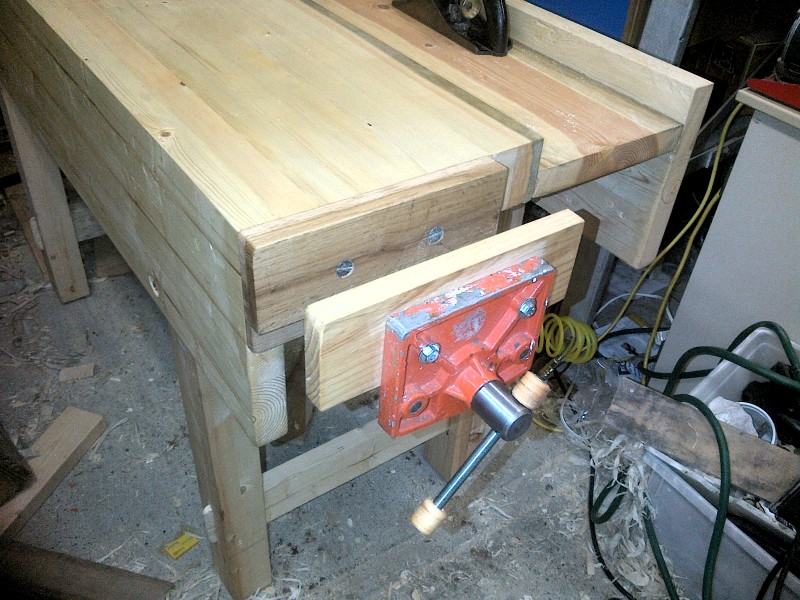

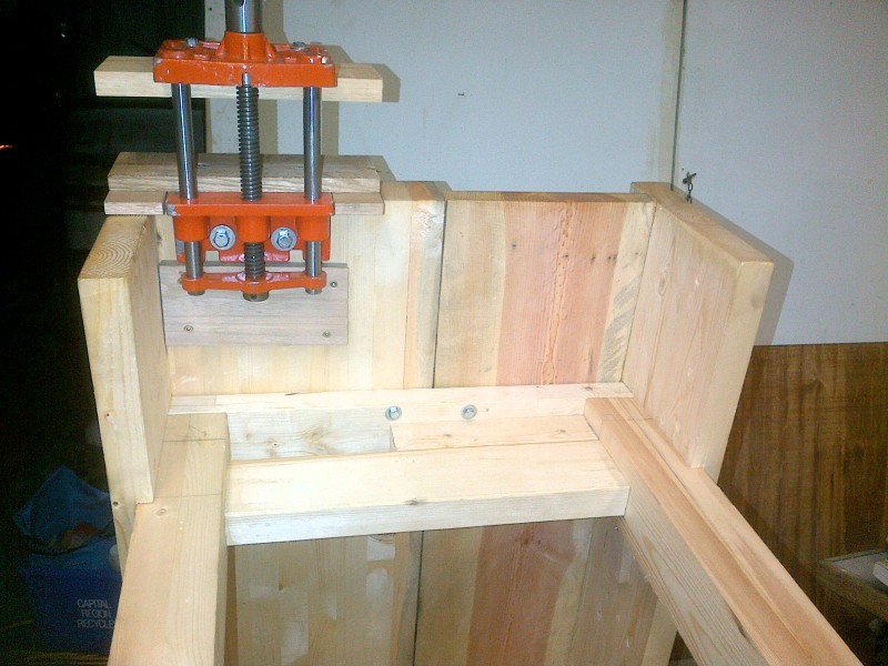

Here it is cleaned up and mounted on the bench (from below) with new wooden jaws made and fitted.
I added the piece of wood between the back of the screw and the bottom of the bench top to minimize deflection (racking) of the jaw when tightened.
[ATTACH]21469[/ATTACH]
