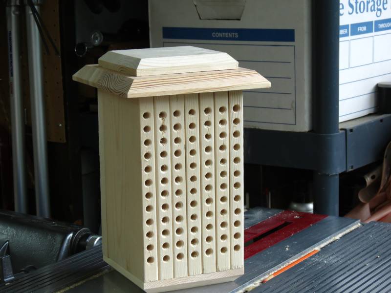

The new design is here. All it needs is some sanding, assembly and finish.

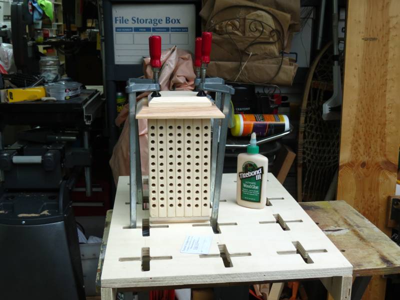

The capacity has grown, 84 holes this time. The design is scalable, either longer or wider or I guess both.

[ATTACH]21494[/ATTACH]

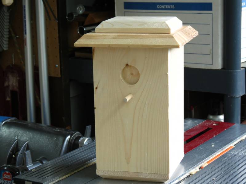

And now the front/rear. My wife was concerned that since this is going to be in the front yard we might not want it to look like what it is. I think this will do nicely to take care of this issue.
I will paint the hole black, going to be interesting to see what the birds make of it.
[ATTACH]21495[/ATTACH]
So now it looks like a woodworker made it, the capacity has increased and it should be pretty much incognito to passers by.
[ATTACH]21493[/ATTACH]

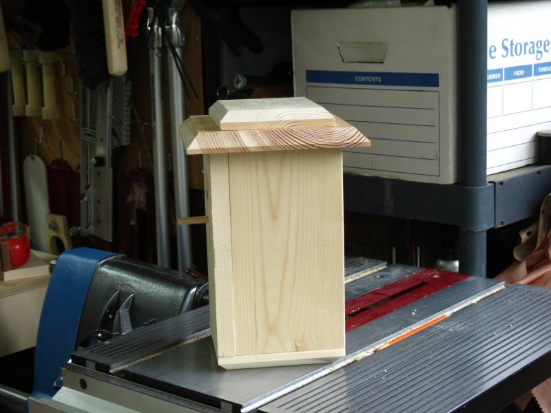

The side profile.

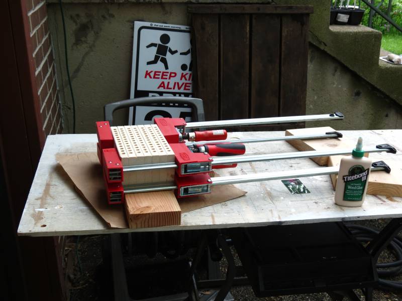

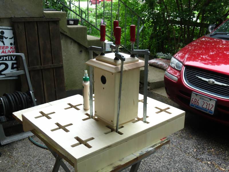

Started the glue up on the bee box. Started by gluing the columns together, just glue and clamps.
[ATTACH]21624[/ATTACH]

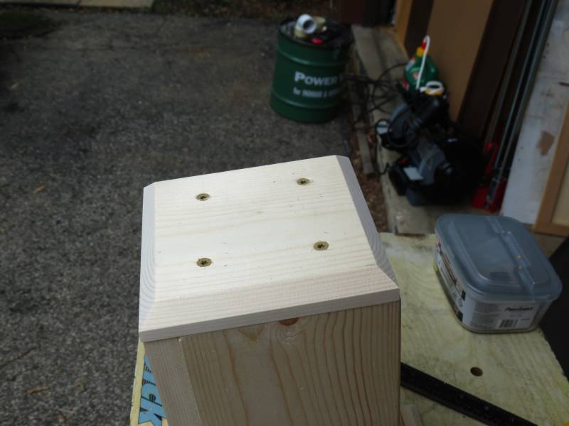

Set that aside while I did some other things and came back to it late in the afternoon. Added the bottom and back, just screws this time.
[ATTACH]21625[/ATTACH]

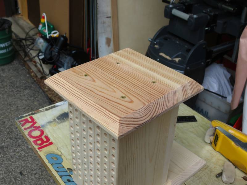

Top was next, also just screws.
[ATTACH]21626[/ATTACH]
The top cap was glued on so there are no holes for water to set in. This is the bee side.
[ATTACH]21627[/ATTACH]
Last but not least is the faux bird house side.
[ATTACH]21628[/ATTACH]
When it comes out of clamps it will be ready to finish. Tomorrow is too booked up to finish this but perhaps on Thursday.

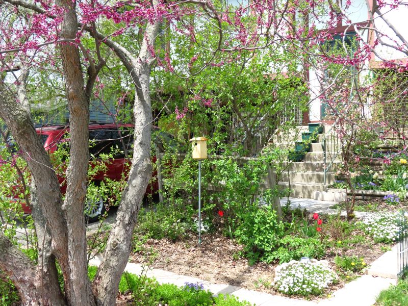

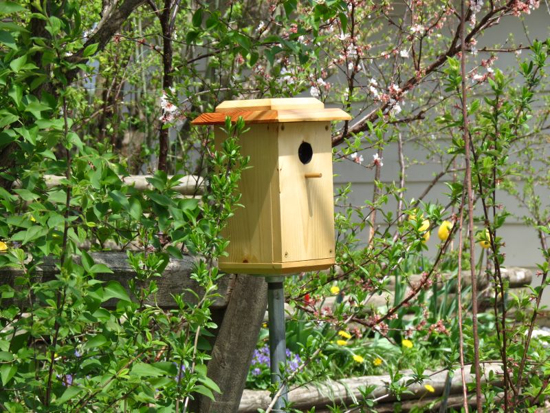

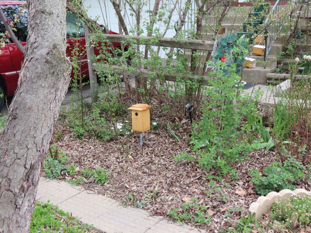

For those of you who remember this post I though today would be a good time to give an update on what it looks like out in the front yard.
Remember the idea is to have it look like a bird house while in reality it is for mason bees. I think it has come out doing that pretty well. At least the birds are confused........
I might make another one for the back yard this fall. I think I can raise the hole count on the next one, maybe near double what I now have in about the same space.
Anyway here are some fresh pictures.
[ATTACH]24909[/ATTACH]
[ATTACH]24910[/ATTACH]
