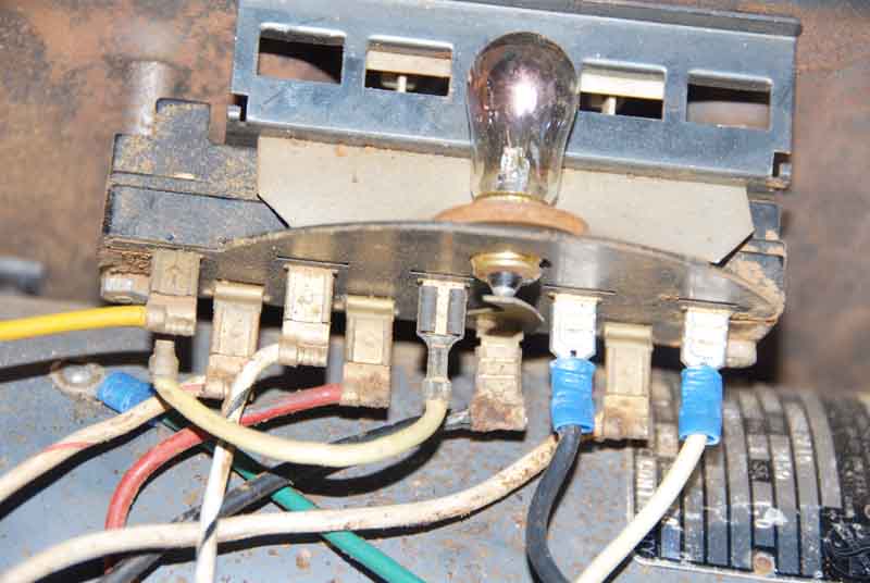

Took the motor out again. Nobody in my town works on electric motors and the closest is a 2 hour drive away. Not sure what if anything I can do myself. I could test with a VO meter if someone could help me through it, but I know very little how to use it. Even how to set the meter is a mystery to me. Maybe the pictures would help?
Do you know how to 'zero' adjust the lowest ohms range?
This is critical since we will be measuring very low resistance windings.
make note of the following:
5 yellow and jumper
2 white with black tracer
5 jumper
L1 black power cord
L2 white power cord.
T9 white with red tracer
T5 red
L1 black
L2 white
These correspond to the power switch terminals and the motor leads that attach to it.
The top 5 are the 5 on top in your pix.
The lower 4 are the 4 on the bottom in your pix.

Get comfortable with understanding that.
Please refer to the power switch as such.
The 'start' switch is inside the motor.
BTW the lamp appears burned out - you need a clear S6 lamp.

- Mark VII power switch with AOSmith motor internal start switch.jpg (60.79 KiB) Viewed 1435 times
