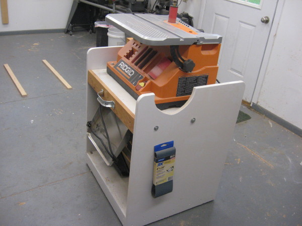

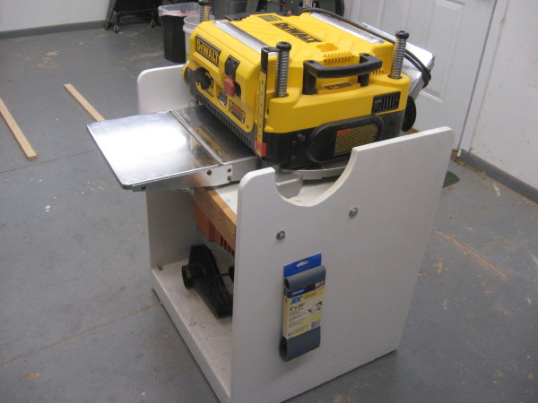

Here's the unit I made several years ago. I used 2 - 3/4" PW with hardwood sandwiched between the pw layers.
[ATTACH]21818[/ATTACH]
[ATTACH]21819[/ATTACH]

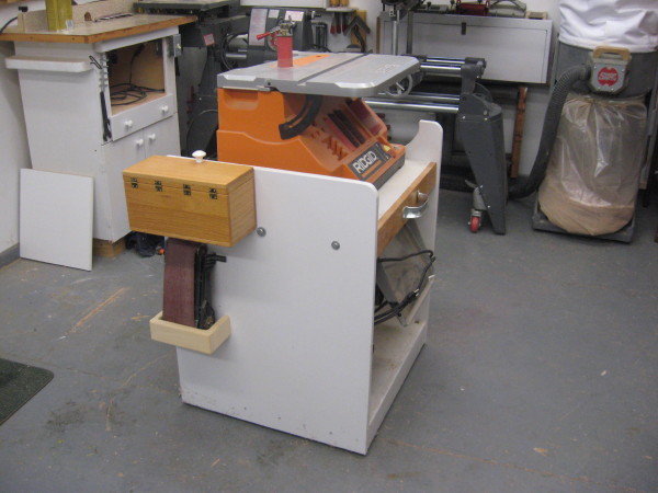

another flip top stand
Post by oldc6 »
This is similar to what Berry has for a flip top. Works well and puts two tools in the space of one.........
It has wheels on the back only . I lift the front up to move around. the shop.
3/4 plywood and very solid........[ATTACH]21822[/ATTACH]
[ATTACH]21823[/ATTACH]

heathicus wrote:That's the stand I just bought the material to build. How do you like it? Anything you would change or improve?
My recollection is that I combined plans from Wood and Woodsmith magazines. It works really well for me. It's pretty easy to flip and move around the shop. I've never been sorry I built it.
You can't see it from the pic but the base is open on the far side allowing some storage and I store some items on the outside of the case now too.
If you're in a small shop this is worth making. I don't think I'd do anything different if I were starting the project over today.

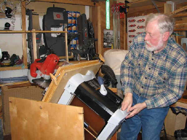

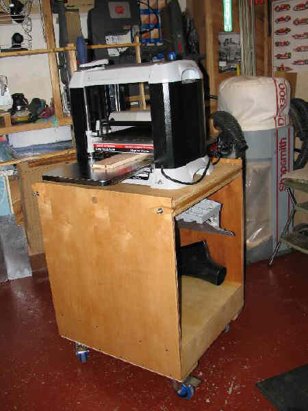

With the 92 pound DW735 planer sitting atop the stand for the last several days, I measured the sag at the center of the front edge of the top as 0.019 inches. I measured the sag by placing a straight edge across the sides and inserting a feeler gauge in into the gap in the center.
This was actually very close to what the "Sagulator" suggested it would be. For those not familiar, the Sagulator is an on-line program that purports to calculate how much sag you will get in a beam or shelf based on the materials used, their dimensions, and the load. Here's the site: http://www.woodbin.com/calcs/sagulator.htm Based on my dimensions, material and load, the Sagulator calculated the sag would be 0.02 inches.
As an experiment I tried JPG's suggestion of laying some temporary fir strips left over from another project across the top (left to right) which were long enough to over hang the sides. What I had on hand measured about 1.22 x 1.50 so they were a little lighter weight than what JPG suggested (2x?). With the strips in place, I measured no change in the sag between the bottom of the front strip and the center of the top, which is a very counter intuitive result.
I am still undecided whether to convert this stand into storage (as Ed has suggested) or keep it as a planer stand. I have run a few boards through it, the largest being a six foot length of fir 2 x 10, and the stand seems sturdy in spite of its relatively light-weight construction. When I lock down the casters and put boards through the planer there is no observable wracking or wobbling of the stand. Nor does the stand wrack or wobble when I roll it over the shop floor with the planer sitting on top (although I haven't run the stand over or into any obstacles, which I think is what Ed feared). Maybe I'll put a similar weight (couple bags of sand) on top of the stand and push it across over the threshold between the finished and unfinished parts of the basement and see what happens.:eek:
Decisions, decisions.
Al
JPG also said to place them front to back(no gaps between them).
I be curious what the sag measured with the planer removed(i.e. has the top taken a semi-permanent sag?)
JPG does not know that the 'feet' of the planer look like.
Besides JPG agrees with Ed - static OK - mobile maybe not.
