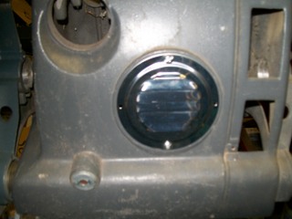

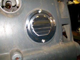

I had good success with using a 4" round louver cover in place of the LOGO cover on the Mark V. It really helps reduce the heat buildup and prevents much saw dust, dirt and crud from building up inside the headstock. I checked several headstock after operating for a few years. I would be happy to mail this cover to anyone having a heating problem with the PowerPro to see if it might work on their headstock. Let me know.
[ATTACH]22085[/ATTACH]
[ATTACH]22086[/ATTACH]

Heat build up has to be a problem for other power pro owners. There is virtually no way for the heat to escape except at the bottom of the headstock. Even though, I will probably not use the power pro for a router it concerns me that there is no way to reduce the heat when running the power pro at high speeds. I was thinking about purchasing a power pro this month but I might wait until Shopsmith can come up with a vent to reduce the heat. I like Bill's vent a lot but feel that Shopsmith could do more in this area with power pro.
