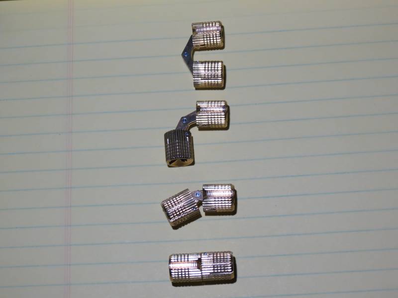

The Soss hinges have arrived. Here is a picture of them.
[ATTACH]22463[/ATTACH]
I've never used these before but I'm looking forward to it.
The price seems a bit high, I paid $3.35 ea with shipping/handling, tax. I didn't find a better with the looking around I did. If I require more I'll shop around more first before I re-order.
I went to http://www.soss.com to get a pdf file of the part but the web site has an error so when you click on the 124 part it takes you to a 218IC part. I have notified them but I have no idea when they will fix the problem. I was able to by pass the error and get a copy so I'm off and running. If this is an issue for anyone let me know by PM and I'll provide you a direct link that I used.
Still have to find latches and pick a wood to use.
I am sure you are sensitive to this, but alignment of the pivoting parts is critical when pressing them into the mounting holes.
I mention this for the benefit of anyone who may not be so 'sensitized'.;)

I am not sure what you are building, Ed. For my project utilizing the 10 mm SOSS barrel hinges I used these catches from Rockler. Though I epoxied the circular plates in recesses as opposed to using the provided screws. The 5/16" size has enough holding power for small items like the earring case I made.
On a side note, I contacted SOSS for another reason and never received a response. I would urge you to check the screws that expand the hinge barrel to lock it in place. I had three that did not function correctly in the lot of 24 I purchased via Amazon.

Thanks for the heads up on the lack of function on some adjusting screws. Can I test them before hand or is it only apparent at mounting time?

I checked the hinges and one of the screws has a very shallow slot for the screw driver. I'm going to make it a little deeper with a cut-off disk in the dremel tool. The rest all seem to turn out/in and tighten.

I had extra hinges so I decided to see how they worked and how well they held. It was during this evaluation that I found the problem with the screws. I did check the group that I was going to use as I did not want to fight them on final assembly. I found that I could back the screws out and 're-compress' the barrel so that it would again slide into the bore smoothly.
